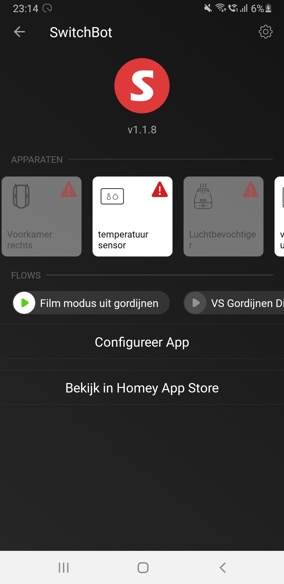

I tried to repair and tried to log in with the correct username and password a couple of times but sadly it doesn’t work. Hope you can help me (as always) :slight_smile:
Can you send the log from the app configuration page as the diagnostic reports go to SwitchBot.
It might also be worth restarting the app to ensure all the devices get the new codes, although I have found that they do normally start working again after a few minutes.
Sent
