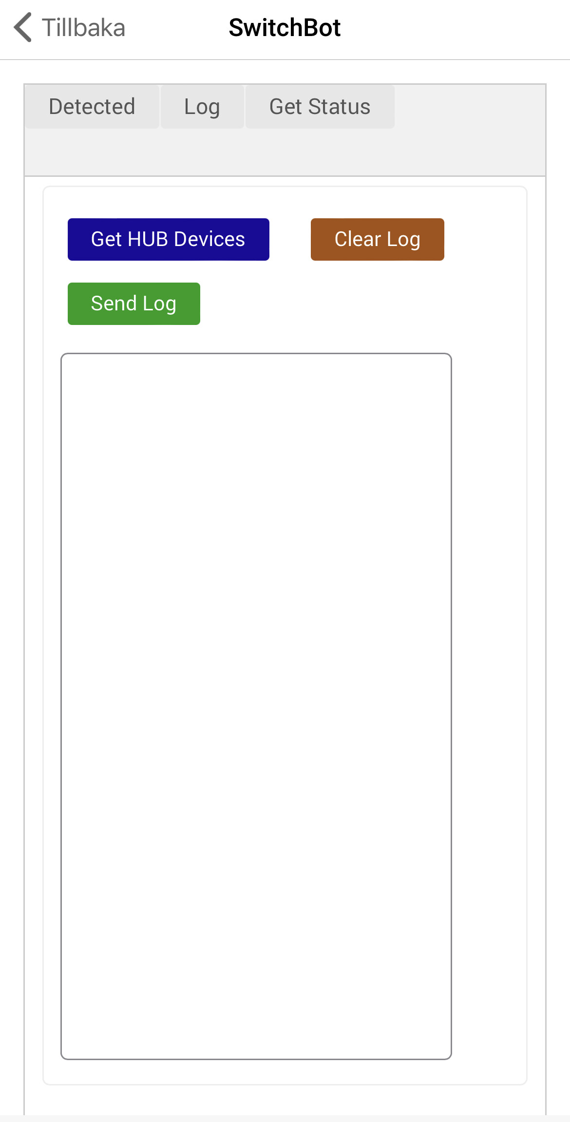

Could you send me the log from the Configure App screen so I can see what is making the error message.
good evening, I just sent the log. THANKS
Sorry, nothing helpful in that one. Could you change the log setting to Full Information, then restart the app and send the log again after a few minutes.
hello, I have just carried out the requested manipulations and sent the log. THANKS.
