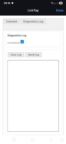

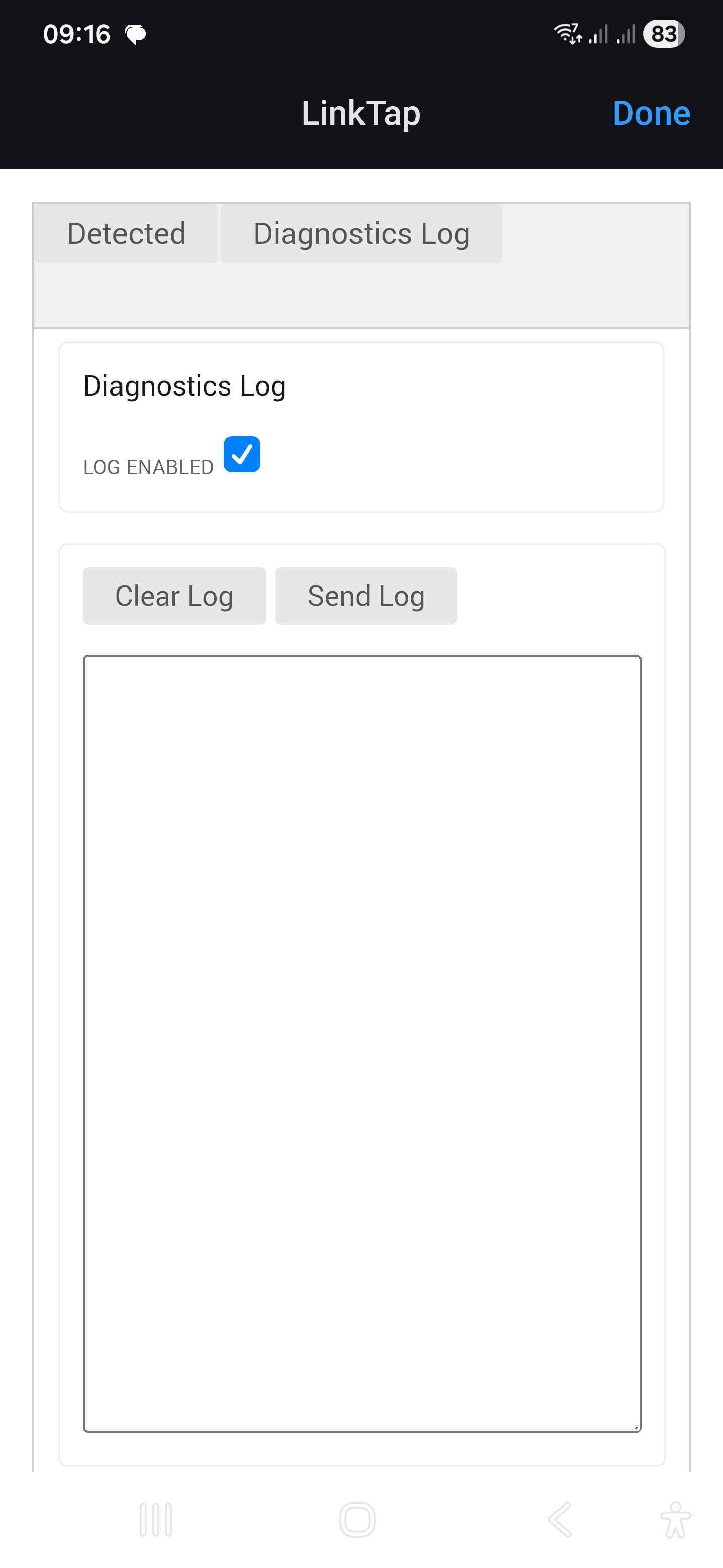

Could you open the app settings page and select the Diagnostics Log tab then make sure the log is enabled. Next restart the app and wait for a couple of minutes and then go back and send the Log.
Thanks for explaining, and I’m sorry to hear you’ve been dealing with personal challenges. I appreciate the response.
I’ve restarted the app and tried to send the log but I get an error (attached image)?

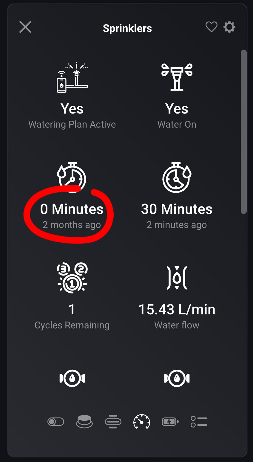

I just tried it, and it looks like that resolved about 99% of the issues. The sensors are updating correctly now (it recognizes when the water is on), and my audio notification flows using “When Turned On/Off” are working again. The only thing that still isn’t updating is the “Time Elapsed.”
Thanks!
Edit: “Time Elapsed” did eventually update, though it was about five minutes after the sprinklers had already turned off. The value also wasn’t accurate. I ran the sprinklers for 3 minutes, but “Time Elapsed” showed 1 minute.
