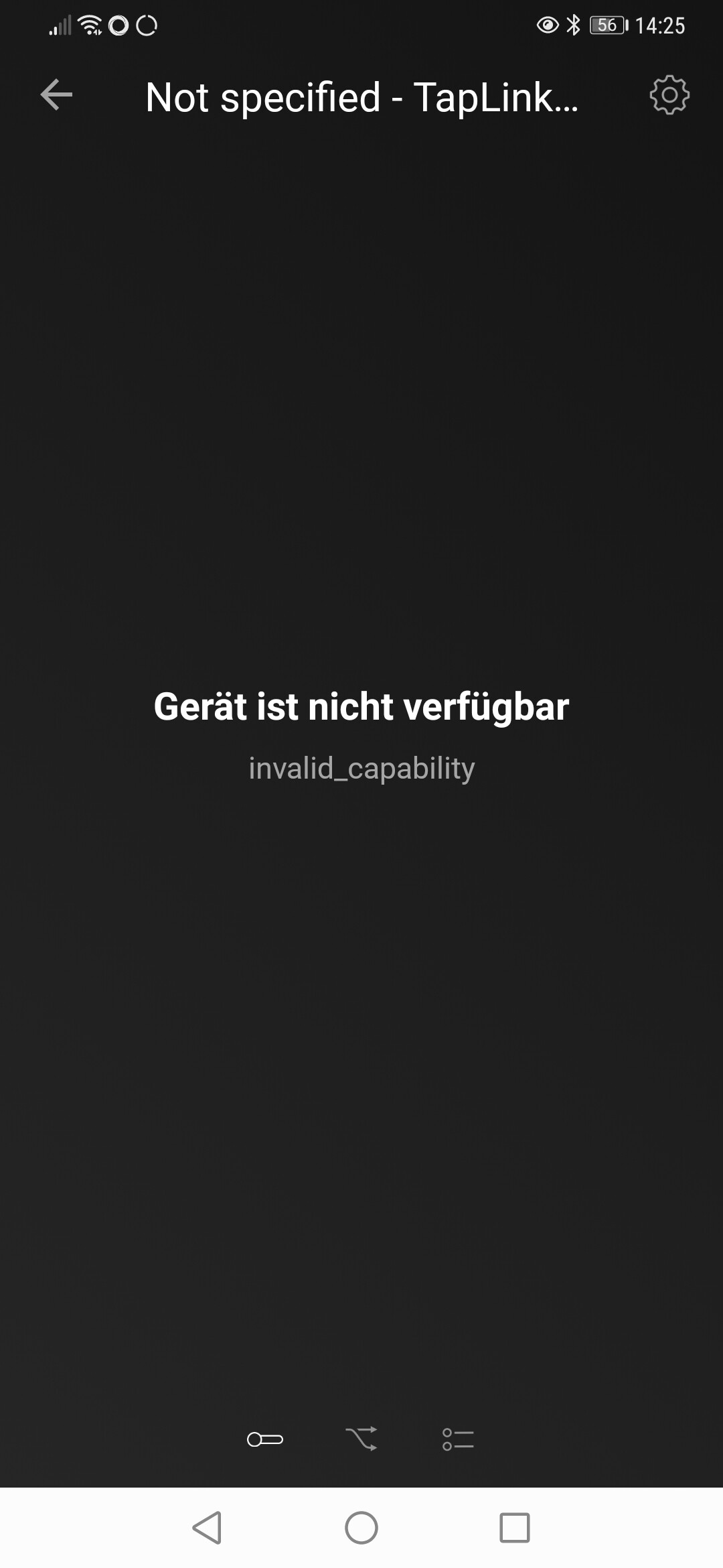

The App is running but I can not use the instant mode. During testing the linktap in the beginning it was funktional… after connecting the linktap to my watersystem this mode is no longer available… (perhaps just a coincidence)
I changed the figures on the advanced settings as mentioned above… but still the same [invalid_capability]
What’s the fault? Can anyone help me?

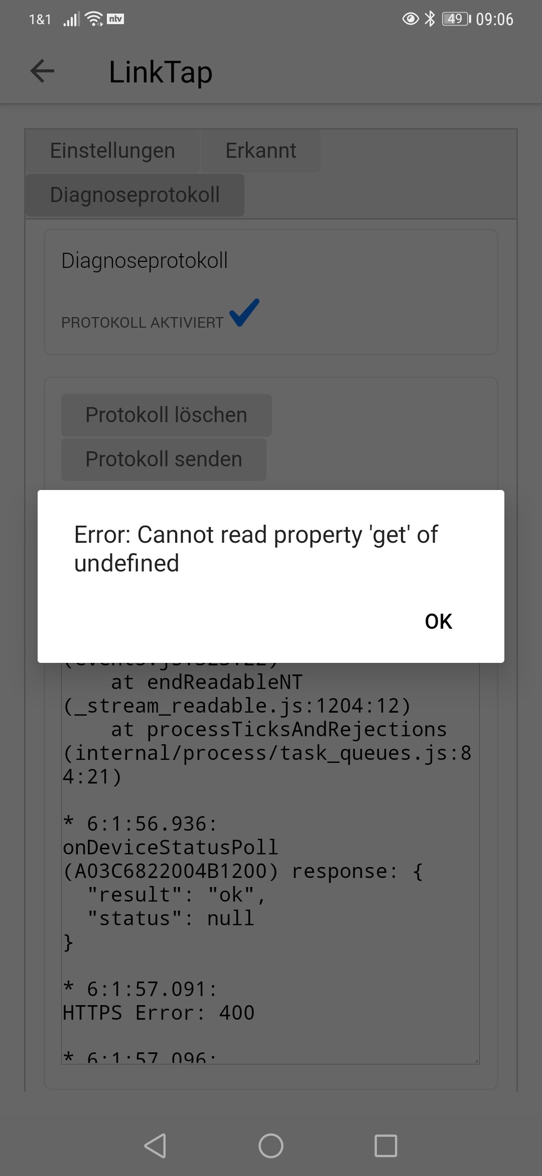

onDeviceStatusPoll (A03C6822004B1200) error: HTTPS Error - 400
Error: HTTPS Error - 400
at IncomingMessage. (/app.js:218:36)
at IncomingMessage.emit (events.js:323:22)
at endReadableNT (_stream_readable.js:1204:12)
at processTicksAndRejections (internal/process/task_queues.js:84:21)
This is the last part of the diagnostic report… Or do you need the whole report?

Strange but unfortunately I can not send a report on this way… I can copy paste it in here… is this helpful?
Or probably this is working for the report

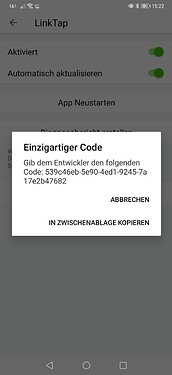

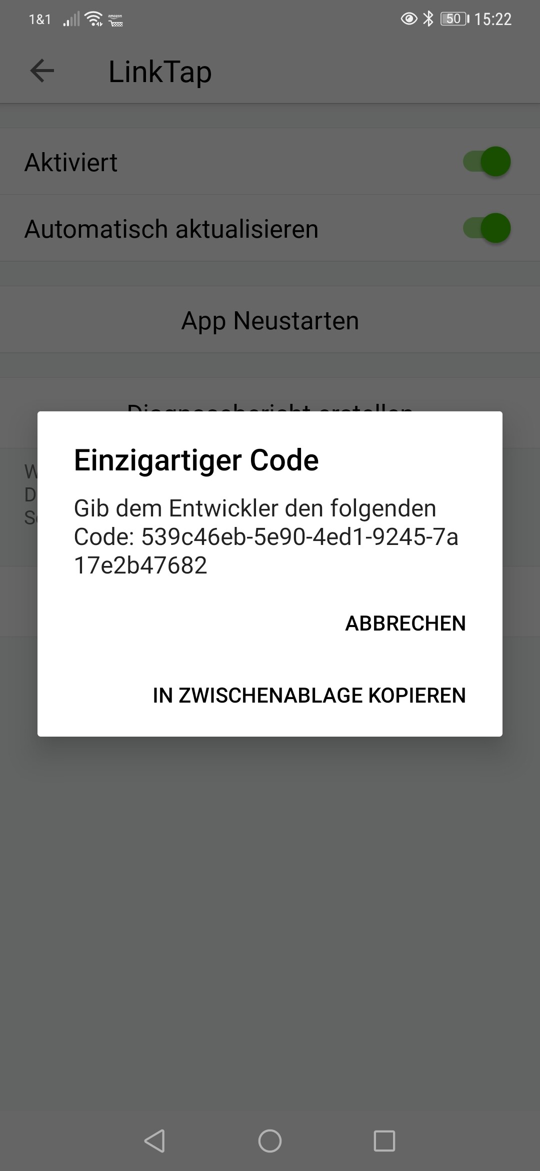

Code for the log
539c46eb-5e90-4ed1-9245-7a17e2b47682
I sent also the log over the app conf. page as well. This time it worked

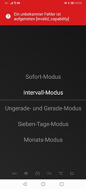

That is still the problem… If you use the On / Off button you just get the massage [invalid_capability] and nothing else is happening.
On the next page you can not choose the instant mode as well… You get the massage [invalid_capability] and it jumps to the next mode…
