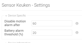

So i’m having some trouble using my Aqara human body motion sensor…
Perhaps my thinking is wrong, plx helpz! :wink:
I have the Aqara Human Body sensor in my kitchen.
Flow 1; Start the kitchen timer
Flow 2; Reset the kitchen timer
Flow 3; Turn on the lights
Flow 4; Turn off the lights
So, the issue…when i walk into the kitchen, the lights turn on (score!)
But, if i move around in the kitchen…the lights go out after around 90 seconds.
Sensor settings under devices:
This is not what should happen :frowning:
What am i doing wrong?
U need to set the timer when motion goes off.
When motion–Turn on the lights and stop the timer
When motion is off–start timer
When timer=empty–Kill the lights

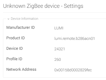

@Paul, not being able to pair or pairing is successfull, but the device is added as “generic Zigbee device”?
There are some more reports that Xiaomi / Aqara changed the ID’s of the devices (without changing the product number)… therefore during inclusion the right app / driver can not be found.
First tests show that simply adding the additional ID’s doesn’t result in a working driver… so it appears that more has been changed.
Can you post a screenshot of the Device information (ID’s)?
Like this ?
:tired_face: yep, same issue… WTF…

So, it appears that Xiaomi / Aqara made some breaking firmware changes to the Aqara wireless switches (known today)… without changing the product numbers…
A quick fix (adding the new ID’s) to the existing drivers does not result in working devices…
#backtosquareone
That means that I’ll need to get my hands on the new affected devices, to create new drivers and also to be able to provide support. Ordering at Ali, taking lead time and uncertainty on which version I will get, is no option.
So, best option is to call for community support… (that is you!)
