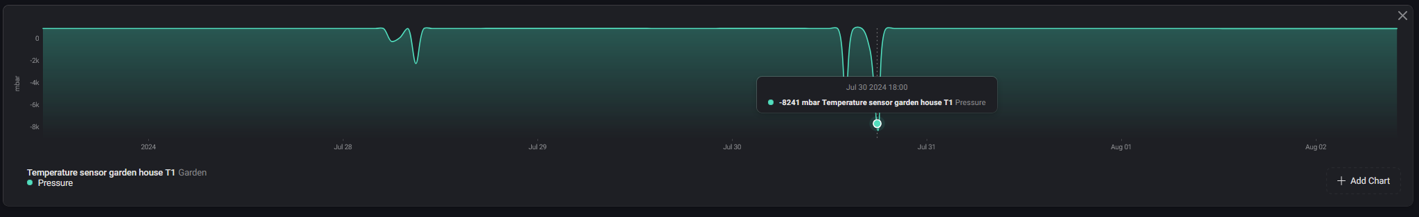

@TedTolboom , if you are still around, FYI … T1 temp. sensor lumi.sensor_ht.agl02 have some inconsistencies with readings of Pressure and Battery , the rest (Humidity, Temperature) seems to be fine.
