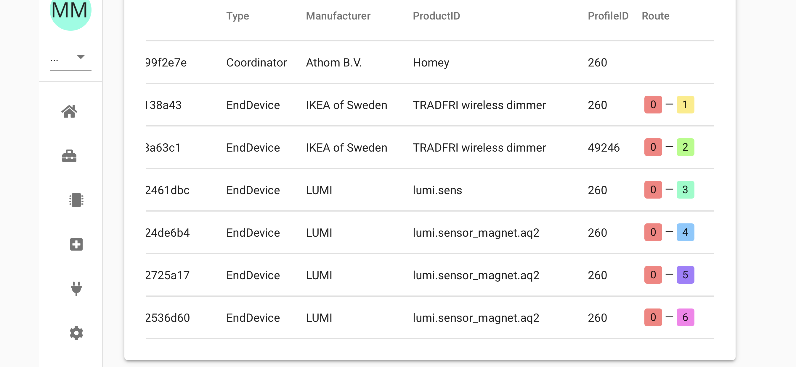

See here the installed Zigbee devices:
The 4 LUMI devices are 1 humidity / temp sensor and 3 window / door sensors.
