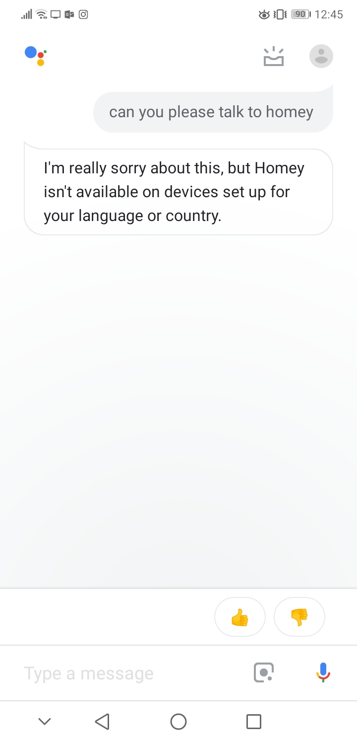

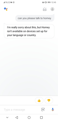

Just change the language to one that is supported by Homey…
So i cannot use this in english?
And that must be a language that both Homey and Home support.
Both homey and tablet with main account (owner) and all set to english US its working most of the time.
