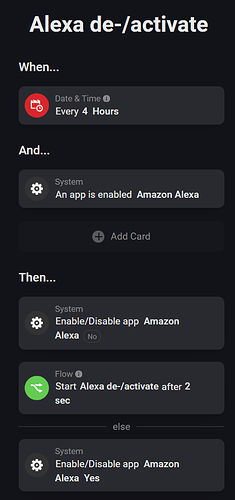

In addition this is also my experience, but I recognized the point mentioned before after a few days:
If this should occur you can use the this flow to maintain the response based on the on/off trick. In my case I let the flow run with a frequency of 4 hours. Since then no more problems.
