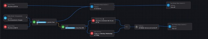

@John_Loebenstein @Wim_Post Thanks for your latest input. I have revised the scenario as per Wims’ screenshot and see if it fires up tomorrow. I have narrowed down the time intervals so in case it does not fire up I ll still be at home to turn on manually so other people will have hot water to shower with.
The revised flow is as follows
But 15 Jan is a Thursday. You specified to only run Mon, Wed & Fri.
Yes, It will (or try to) run tommorow morning.
Lt’s see if it fires up.

The combination flow as suggested by @Wim_Post DID run this morning !!. It started and stopped as expected.
Thanks very much Wim and also thanks to all of you for the time and effort you took to contribute to this thread and help.

Exactly that is the Why not, The WHEN {Day is a,b,c…} triggers only at midnight and at midnight the time is not between 06:15 h and 23:30 h or whatever time range you take, unless it is a range that includes midnight.
Dirk,
Tks for pointing that out. You are right.
So the flow should be:
When – the time is between x and y
And – the Day of Week is a or b or c
And - water temp is < t1
Then – Turn boiler on
Or – water temp >t2
Then – Turn boiler off
Do you agree?
John
This will not work, as no such flowcard exists. You can only trigger at a specific time: WHEN the time is x. The card you are referring to is an AND card.
If you need to check something continuously during a specific period, an option is to run the flow e.g. every few minutes:
  • WHEN Every x minutes
  • AND The time is between x and y
