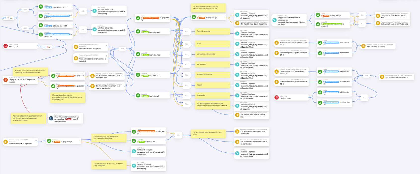

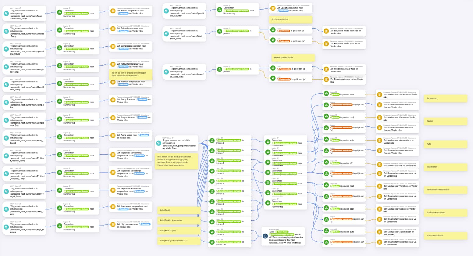

Works Great! All local! Had lots of issues with the power mesurement on the heishamon though, you need extra hardware thats already more expensive than just these 2 switches from shelly. Eventually I used 2 shelly gen 4 pm for this. Also the app Device Capabilities is great for creating the heatpump as a device inside homey. If anyone needs extra info into how this looks here I have pictures(Stuff with red lines is no longer in use):
I think you can copy my device capabilities device with this data, if anyone needs it:
Summary
[tef:AVD,FLOWS:ā€œH4sIAAAAAAACA+y955IjOZYm+iphYftjxphoOoRDpFlbG7XWmr1taYADIJ3CncIpZ/ud9hnuk13zUBnBYGQyuyt6qna6/lQkSYfjfDgaBwf/da/N3vdMyQuD+6/3RbItpR7/y6Rgv3cYENVoncXCKzqVqOB3yoWePO7DIFiVuhNIT4XhNJKmvDU1Qo75bZrsE+ZUaO7QfFdu5nP7tTdt9Ne1FdXLCCKkEzvM9hMcbSEaapUYK7xXCz+rhs2xOCVn28DZucNeYuni5vg86RZLbnN7nGaWJRSs2MhlanMeElvdTmBdltPtiSnvMSUDlGDFXX5dcyXe9zfZVZskk0k9g0l7XvB6WRS3+yMvcJw8tjO7Wj+xP+31VicjjQaNJGkGWI34mdbTq7qtum6iirwOXubwdty3VIV9O9sN7CG5JqqfGm4PC7WvsKrH6jraezKba3uzlF8pHJP5UrlWDebOpHy0bRuabuHUkAmS5rrJRDKvSFVGmdPMKwuneOB9t7Op9ZfpVSdRm64OySUtt2xqN++u6+nypNhaZNEik3LLk9lyfkivWq125nws9Ka7zMzMTxM0bGRWqUQ5U25781ma9JZpeJBebt4+Lv3KgvTz6bM/5kImEmnYaRyybTJdLr10rWdDOMpEg9S40D1M0LaUm+fdwzpTXYSH/NmPBo6cjOxkFI7miy5qd9xab3zycmar11FbDxrSL05TZOpEZpUhSbxsTWtBZZSSrWmjtsoEqUqpMTlklyR0putMLe3wXJBas2xtMm4E+3Y6xQtRsrotTcQAdYqjHp2ddsX8epev9manXM0PG6dM7SArLFz3l9ND0Bpir0JKi5lzmBjPyZwK9HSQxWzFjocJOpQsM1Krfa3VmyKaThWzR6zQMTEaF+Y+n3W8zEgjmq1Mdrnl7FgpZ3R6leqmp4uM6zmNfDc9gPnqNJs5wIatp3KyQkh2xjqF9KiXy/YrLuOR2phaMeoND3OL14N9X2y2s9UuIc9KmOlpyGw/UOV9fawXjZ0I0ZJZnKhOt+12d5Rcn3i1vl/1qPXKqVxmGNRnqXVDDhaJPOyITnniLIeTViqV+vOf77/ce7ttFC5jWdzef/2vp39+w/RSMvGgex4wVUtnckM0mAazwK+uvN6gPyk4i1qTqkERl7oyatUOXjvD+lOaLFWCRKM4moxSs/QaJYs73uxzdZrxRB0lgzIpnKPqYtbpHENmgn317JkzWolm1WXUusfl+ZDIQ0h2MJoljBaQim5Fi01rvEMJv1xPl4vpUnEQkswoUUrlj05eljO1QyqXmKqoU1rDTnLRXpdTS1zpjFO216ujQbblZ/K5FNrnD8XSaZtlKbMiOegFp0WrMaxtl4WcLrfq/fNgXqpX8aJbnxVSuj9GuXCwnLgqC3t2lptO5wivd9l5rptL4mmtWx+FZEEmJe36y1o5zFQo2tRlwVsOhbOSDlrtS531fpI4l1MFPzNcheFiG/H+yQuK6QpLbvBgttI7uDrLw3G46u/UFlZIHrfWZSuGq9yqNBvD9LJfHBIi6TrBN2LApni1lzWnV+9tyKlkWHYw1JvsNqsOPa+DytXRtFpanuqkJTap1UFltqPi4VDZlXp0ecxmF7llI3vI1WaVDCyOWKvKbXpemrXpKLSleavkm2Sp5HVCte7vVoljPneELbhMlllneJwH7anf7PY1i5q2nOLNooX8XAy2zdkCsUpHLCNtTTdCKNlECZUd6yak/QHbJGba2/gsQVu1t9z3jcJLdmOw1x0kVS11EvnENOkUT4NKbn2qdhal3jpbdlIsbIZpVByOa3mPlxfRNM2yi7FNwlSjt8uEG7yt1TLLSr7OZ/jQa1bPcgPNtsJUfbt2C36rXBvkC3mzodvTonhaJ53psFiC+81htJ82MnjoLczpmBmg5HgK08Nse3do62iXXlR3erYL12JwqgQq75AEldNtSfTDXQs6x9KgmhDN5pzY3VDQ86qzVwuaHOrpYVGdlrv2nOtWqNfo4W7S1FL9ymlvbG4lPWJIDdajDl4egyXvnerNaoL3VOdggmw/O9brdreG8CJTTLUFDFcVVKRivdq0K2gic52AeYXOYXhCm4By3a+7rCBrZUR4BzcOXbHfHfQ28jXE3T4Z10pWFtLlg9i0Nsd6aps8ISzW7ro5X29G27YJxG7fD+tBrTXLV+rRzq+osc6paJRPwG1zGQUEJ3vm5DczZW94wOXaGalBNZryRfFcy1WDjK9HprdmJdfxki10csI5XnPDVZQblozt5mudVWeW9FB7v8pt9pmx9Q7OZOeZop42BqnaOsynKrVdMZ0p4UnXV7lUzRDSZh3sF7s9M865R7LVgqbJJOybAqm3tmsxWbW68/5+Xlycw9Gg4oeNVSNbzjE7GrLFLJNpbf1ce1luwzDXPi42pV0x3ygUbDqdaJXafjqcrVK2HyXHxWI7VVzORaFItg13s+yVPBfaYlgf+6mUn1vkirlU7jBJFBt+22RqrC8rq/TU3QxSfnWUd9fjniv3fVyezErBqswTlbpVw6hw7nSdgO9OGVQ/n2Bx04rc+ZGUGoewGY4rfnlQDMrpiZnk56PqopI91zPVdms6GaXEloXZ1AF3sk4l7YTEyZU2tSrMek6pIouk5E02nUIWzStur1vNz4fhjlQ2+ayXS9WbBHWc9LbW1+Nyp+d43X59ZafHwzZn67ON8lCEhF2EC5ifHpvBqOENEtsJhcNJ+4z8bqNPKrV9cmsPdjFtjl1v0LKhnTWTLbztzlvpSSr1XXzhO/E9oU53QFStdcpvTuUaxIdle7Se+7Npapfg+d1k69UP80OiV9yi2SJxGObS/riUaOluN5cQjQXVyHQXxjI3ydp6h4truBoisVkmgqQt82YgOE6gHTztdv7eNlcQBm6EV3zT9TB2eFBOKoKZW24FWOarx0m+HeFU2w9PZZbD3SFcF1YV6E+XJtUI2s42tXIybjgfeaNCwzOZgVvMlMsrlFN8zjJeSc2dajajWZnkRpkiG/nd1qzsr/xurjwaFVPdc7vZTvN0sSRHnZG/a83TRT3P+0td6dFMarzMllI5092l2qRMcnCy8jrZVXrklL3iZjWZbmyyJYLiuJDZR2S9S+dgunvqj/b9hjdKjfSqs69kw3J9KoYFmqovO71pVpaKq0JmnZMjstWd02g9MZlWr1Zd58rFeS2b66x7yVFx1cOiXao4o0y3z9v7wamKd6vJatQbFjokmVpvpNrnkVeqBPXSoLhJTxbz7KJd3XdSSzGOiu2R6vS6zna7PXZCLz/dOpkUqpUmGrdGbo3UsqNz6ZA4VHt8gluLDhbZ6mRAM6dcyV2TbqW+5qfaGu/ni9N0WnZRq+xNTtnuqFeqrt0ohRIKOc1TcrNbJBJrOQ33J7ziCUFxJlk8JYtR0uaPSGPb7xZt8lDfLZfTdCZ1aTnQO0cFwe6JMNlKZ/liPD4HwSjpRrluql1xXb5OLw+9XD8sL6J2hgfHZH2Wy4cHOiyw1WbdZj2xE2fkFfdqppKNYbLRmNRSyjT2E4rbfM9P7JAcUq6a+yMu5nq2yHcmkfebm6rSPBpPk1nRyipjtcqnm632opAuFVIoxfNhfQaH+9JyIthqvt4enUUprNGokC1HrfpEpvIeOdcyk0J25tB2v5Of+tXCejHI0eVmNRBsfJxMZXqYLyyW87zXk4MBkYNBpEd6GAwXNZUjLWe3qc3zJr09uC2vETibVmKhZD4pM6PUohU2s0G6kKkdatMFd53QaTF0nIfnef3QCZHMtw7T7mhkM5WGN52Mh+0QVTuVcmpdcdPzmtWlctFdiHTIOxKfMqewMIkOrbZvWTDYdLWpLV0IT/Xd3DZMzQQqOoklTa8Oa10elnfzTePUgFr4k6HNT1iYLkDXlTW8cLtmx6TcjYfQn6VlKuVWV53p3M1OCyKPZgQVdc/PTDpydqwPqrw75n5nOOgPg3z61PCn61lj20huDnqWbO6mrHLqBBEMcKK5w0u8S2BzFlEET2LpjsU4mWpWTqdESh0uWch137NQxxmwWX2a5t0wy1N8h1PbbX9xKq2ccLZz6tN0rpIdpjezXrvNdWc8yPdO7ex8ObR2CNOnLV5MivuWrE00M6fWbg+JXeLxMAVnDvbcstvx+n3cXjhw6CYPJNnZesnkbOruNyh/Ko5aot8/ILaeHodsY462slejaKuP/mJXy+ZWvUPW3RfFTCR0qpnD0XrG+oSlZ4Wzgf52WRqsBm18pKNoaU/9WifvJzmyNKGTwY6NG3W7pTLB8DE5nJW280Q30mUeLE27rnL5Sgc3k+mCFk0HFfrliu1menwl5g3dTJ3YgZHVcdc9Cz9XPmzxuTwNguVkVl2bbrrE2om82yOSr72AbnRU4YWebUcnHbiRwYVkxorFuHUS1ajU3xlEFePd3MwkTu1Bo7sPhmnWSDYU9QOoK9ktdFW32ZBLgha6vh8nzSKodwPDKE8PurN8mx/C4XYYrSr7xqlSTQ5bRbY9uRDC0UyE53UykrPz1vc3wZTm5BoVdqOdogeOITRwWk/A8dLWm8teZ1HKN0OWH+X3Cxd1KvXjKAVlttNNd/z0OFOqoXRnHnbCqt/ym432utifqlSYle1w6tnatFxy8m44ReP9Zk13cOFPu6XcPKwP/CKe1PUwNxm0M5NyuZwuBodlES/csFW1jdTEBE66Ps8veoNePiL5RE8ljq2gvp7yWuaUa1GccVPjftk/UI/m2pnTvNaY9FYVH2V2h0ERTaYVR68HtXSvs+kHjZWb8rP92gbmyKieCmuFMNw2tgN/mp+UC/upDdF41mvuW9l5hR3WKb9XmKyW80Lh7B+2aE3OE77OaDqBKDtLzCfWzAM8O40SQ9nvkVTHtpcU153KIJ8vtdazRkJkasN9r9aqnKp+qn7I5ZaZRb4XDlukMy6PG/lUPb+GtZI1RzmZluVgMm8dSb9BWD41Lk9GR09mOmybSm8KcNg4NvlmuOIzkVImq3hu5+C136h5eM/TtD0VaDzPxfL6SlyvaPzOcJBUjfSjuKaPzGb843BYWs87mfra0dN0rpGmWZ3tTXHklMvOtl/O1TqWkmQzzFY69fokeyTNRqehsST7vXsySzYO25vCaidOXX/irtnar7q73Xm/SCQWHknuhmdohrDoVA47ut5Mt7iXPexRZE62Eigb7aOjvzCP4lqkWyZmkdReLK6hYAPCjrPCKdnfbpepwWrQwokHcT3nlunMMZnYML4v2CncouJyg3izuTwntwtyKpeTczrsqDId1nqDabk1j7A4Hje2G+W385PNk2OhUUn2U4Hm9WWEUKVml8f9fJfxmgPS2Y6z3VF30W9WJ7n+Oun31l59MGzMRH+JFjKLmqPumNogmu7PWRFuKoN+qN3RtrvE3aRdlTp1xsr5kdtI9D02Z5zuK5lkV3f18lyR4+jc2xeczXhFG8wxWQfCfSPIbtzpfNUoBazQPMO88mW/ydehTmC35zIazgz13KYyVU95q/XqvJ8u19vpvNYvCWM3J7LfBEZJb18JislqORPml71yAE+bgzs8Zguhk5UivS6lFoPUdpEpVFurTi7fzk3bQWGfn+TzK50p7Tut0mpgasdaJbc4r6bLzl6t+S4/XfvdUn4etjsTrMKmzo6ng3Z6Wi6nUkHgLIfZkI3nBV3bbr1iqtLs5Ze9QS8djXq412ej6OwfW2aQHXVynpz2lnU6OY10YVwjcNQpFFuV3rQt20Wv2p312otMBW5kbj1Oh2d7SEzb7dUyv57qbWXSa6cm292k559LOb/Wm0ygHR/as14z6OScau6wTk16g3CVmFdy5xrZN06nQy0t6BQu07PJbN7Zl8aMeAGz/bBf3ObLoiAjncnlw9ZmZk4i43a93rZVOhV36X4qs9o56wqe6vR0fuqceCYlN+P1uJUQfj81L1Rag/q4lpl5m8S0lptUxo12piSW43R/JtfF0jK5SfqJ6WlaT6aXfBb0db9cLKaS0wROZM8rVF2mLpJK3yB6l0VCnROi2Vo6nbe8f4JHxu28k4IVSk9dWWV+ZZIrLXOVfKZ7pmJ7oOV1q1n2znpyFlGhz0UBn/IJmRjUSX418f1gOipk0T45cLZeVteF0xicba22JdmpM5Beb7Wu77f9hZ2JZlGGVVtoTXa9WmVZYalByQszs+0gyh3L/YY3TiOy8ecp0u6lD7XcqVPK5BITdtrnW2FYLbXy0iFyUez1y4OUJ3NBx8B8Nxn0nEOllarwVmLSGtfPHZlJ+0HDHouZcBTq8sH1+BmV1mR1zobtdn7s9w9rp9dhHj6k+slUu1jcYX9sR4V2KwvHx704o3qvNp7nxtHGP/oqv2/vyofl8az0+jAqFKFNbFhKkVK5HEzWJ9MI1GHjJRojBLPDxml25Kt9adhKjZMDMsm81ZzXXOUOSahaOpuonJr7VReSZbOoKolsqxhtqoG/gU5+N2iVKoNpu1/uVDvJ/aYyXcLROovnfIYSifOhuZDdIOVs7LAqGlFu0spVZ05GrZNZU9nk+PCYMKdThSYHlT7BXZuZ9HLtQeCqzKJZpwUbnN3hqVoslLZefjhwFYu6w6ESXsENaNP0TXoMkerbFSrIAKtgp0S6CZV/xJ3xMqnUvrhlIkSpcVd7KGpWKiIRzjKeIoYdJsN2z57n4VDsBk0m/XUt8lk/MVRsf66p5iijp0MSLlOzkAzaIrlqdsxOp5It4dVb/jAnB24+avQThWhajZyQda2fXPOgj812UZppv1Nk610O992GGrSOXW5cJjfHWm2XopZn7cw7rwbkXGsE04RtkohtJ6NZQnbHDYK3rHsod1hftVel9bYUFYfFde18KLUbqDeY6XVu2irURgvrjfq5bDDMhrUcz0/r6ZHTWDfSBdVDxubkspSatX3U7Tv11Gbs1NbFQ6o+9bfjqvUHqXOhs5ROfZ1fj2Xfh/k81XV3W5+YGprUy7PTitRqs0ZHqDDKRbWFLpWrCT/VmHfKnVmOuqcezUSLSbm6L5VrI1zO5nLVdv18Gvj+uNlZFVfL2iw3nxcq3ZxTKeXh0u/P0eE0QP1WgfDpsdLtHtetbqPVGyHtO6Yh0pVue7uNUqVZzaW9NI1m+UW+vvDmYaNT7WzCuTMu6sJ23m/JKm7J6iDIzdf9QghL1aZYKJqZ8cLKz7hzP1x5B+SnW4Veqr3tL7fHPhWiMdUHLHpj0aiyYNHsNXaEZvvpVpBSwahSJYuFl8O0TI/lEayrdMMtL/vwmGhsRXVkaf28bMgZmadTrxMb5IrItE+EyFbrzPNyj3G2j3ZuokTG6W52d2iyFE4fKtnoUFpN02eSpH5h2M4GpKSXu0q038gua9s0MU3KmniWOiZ6h0QBbxLrlVnVE02R3AzXu62dTUbWN7MIzlZLJrtMyP5c0GRwSihRqMi+0xH9LQzttFHAgyHbs07Jmn1x1yxmaq6p8m66sBmcSr3JptFNBZVV1Oh1eL43GsS5jq2bPft5hrup6vE8CeemXZmrtEPaxxI5T3apKJGa96dt6U0anXCxa+ZKfVPas2V0YI3pSGV23XECHdrbY6dRKqNhrp5fHxaZMF9qd9g0e8qWtakNCsdzMnGel2qkbdlpkz54lV6z1z+niv5yQ1GuWu1uWlN/lknI4NBz6ZxO/LbCjm9b88o5lejPlKy2WudhXfWa422uF2XmdTkN6ls9LLhuZzrwwx6a17yGO8gN2r3lIeBqVRTLsD1Ca1xFm3S529UNmc4lu2mnuW8vx2xT3wU7wYOtpEV/F3X1vuJv1tkMSg5DhIn2VeTC8Wmv0HBkTbZZP+zapHFKHpzgLJOp9sRf5PI49Sb3hci7PcxB64RYppU65i0fyM3OFmpYesvR+kDLm0SrqNud1qJjUtPwsNNDh2cy0wF2QxPNNpR1Z+uxaOKEx9ZwNorKueX0rLOJ5hFtNlM92yX7osfP7iS/4rudvz16Q2n0gCYbeIAmymwTq95osBqn2uWilz7OK9Uq2WxTp86q7dYdnlosl2IySTuNRndk5v3d4eivu/683ytkj6ON6rRFfRr11/VwmW50ZSUrS6NlfzpQXi3Xn6zCGnMGPqn1ptlCa5JeinbOW/RK2ZlcZNer4nrljOcTMccTPzfv5Ma11LS28lrparJVLqS9w3A7y4Xt2rHYSpSTtTl1EjWvXK329qa5WdCCl5ytIZuf0mmyqtJTIjmKKLWJXX21w8O+WQzM3pIstSzcrCfpt7YN83fLAHsIMa89edhKRkvP8Cy1h8J8RnE6eViyPApa2U2jNNXqTJNhtZ12urQUzrpzv+GddgFmJk3s0OW7AIpkccK5KU7qG94kiWE1IYIRt8VFMplk7Ozhhbct5nlzM0v05DhhVESSi4NO7gWxuGqyB5NcdIqokeqOd7NJSaVz3hKXi8FkbmqLQzXvZtOF/aCSm4XzXLpO0baEqttpfTSeHPvZ0mldGGWnw7C1SU/W6/Ro6mSXjXkNjtqkGYYHV0TT1CoVbbPbgkdP3cO4V58iG61mpXSBDebTxT45zZac0Xnlrw6H09ZZnrekeqS97HC/Kbp92E2nz+1GtzUwTXfVbYUms+g3U7VBJpz2dw3pH9tdE8HZvJPL53qF0X4Ik8Gk3V4nd+dOOicyuhUUBpv8cTFrHTanU150t+PhoTNozkbkwBLrbSAyJFEms3P7vNpk651ZarxuTCooyMB+2D216SK13eXT5W2v5h7lZgCXFae0Pi1lcn2e9/LjWq88G9WiVSlX8qExRp8TND0YNmvl83Qi5hKGHdyJDqaX3PbNotX2vXmSRIR2xGS+aIdhp3dcV06FFW5Pq5NOs6DPcoIzQX4zPy9MZ6KDRrqxWJ7atekql6+moLK0wQs4mu538ph1ZTm1XqT93TLRa3T7C55k+XqCOelMlDeVHCoxey6Xo+xQpGvLVJjZtsrjSkYcCptJpTCSMGi3dQF7qzGbBM6ukdO1osyGnbVCbKdL2z4fpdb9BvLrwq3vJ6NlfRJUnPFo420yqOfv8vv61h7LuTHBm431R/NEwi3U5dQjNCHq480yn2+Ph9AELTkUYXaTjFgm2XMDPE0WhzDZdE1zVj/W2o6lLWvdhJ2FJphRvd+QRHPq7hhK0j1uOtntfDPsrGqPAfffv9yHG3/iB3JR0vdf7421UjMsgIMcDoj1PCANdoAwwvUMtBoZ9/7L/dZEkR9MHjaTTWA2k9O3vVzszLd4hzmSQXT/NdgtFl/ug91SmU3Dds0xyvtmobf3X53vH9cf/v/8BWTfv0mH4cLI4Moz6V0UhS9fkO9fZOTSbOSVJ6r+9uXl8Mu9t9jef72PpmazDLeRjO6/3KuHMWFdLs391/uUDJI9/9XnmY2RkckvwkNGbuJRrFxszfevp8abG335cces5EZGJiNXUvkLP/LNu0c70/CQiqcTBqG13x4/jaT6/u6sv5Vq8X70xzl15eT+a7TZmWdqn2nI7Ja7hYz8vbl7XKD7l1/8cF7Pv3me19JEZvNtFR7M5vsI7/B4M4Ne4Efxo/PB9PKR99N9/LwUbP3JNLoYCT3Rkt+Y9c4EkW9exkM3EIFeiNiaYBt+nz/64fzRU8nS9yKJl2+eKSuev3+WNZ6/lIvXHIdqfvD6nx/Qjn5EO35ex3C52pjtNtzchSuzkZEfBi8vxzeggD9CAf8QBfwWBQq/P/eCQrjbbL9//B0I9PLZWyDwB0DgHwFBnoAo+pPp3QMUu813PiA3IEBeMbOMn/72fpgfYkGeKa5MbNJbou+PfacZvnz2lmbyAc3kRzS7z4vfaL68y72BUvejtXZ/SJ/7dq3h97V2nyn//smVZXbfkux+QLL7I5LpE8nN3XJ1Zxfh4eWN9AbC6bslPsjolcaiP6SfPlNZTS7979JFr5BK35JKPyCV/ohU9prU7coY/fJKdgOt7KNFZj8kkn2o1tgz+e035LMrmo29JZ99QD77Efn8ifxSMDHbyCy0udubzUFuln4wuYvM8kHN7XbfCeM3oMJfUInkZmKiby8DvRJz/kOE+DMO/9//zXx/5IqI8wcUXjs4/AMg+I+AEN/djX1oNldJFzeQLj5iCPFDcsU1csUVcsUHxIkfEQedJ+raJgp314mDzi2uiPMRedD5sR/iXCMQOlcohM67FX0e/L3H4vyQ7Gf/K+0HgQmuk32TBwbfqbRrHA1/4ovBqxjAaxjA9xh86LX90G2Dz35beudHH2FwiwMHP/Tg4I9dOIiuko2ukY3ek/2RwwZ/6LGJtwoW0Vc89/FX6MpXbzz8y5c9ffn8cdePFqa72cV4D+RmGZlVuFzdSRncX/9tPkb47Y93r2Kd57Vr7XwT3S1Dbb5/9eMwCF0Pg9ANYRC6Rs33GbyhBl2l5tWP31Dz0/jqAn/yHX/0QeT1njvefH59vZ7d+WYcSL2FFf8YVnwdVnwDrPgarC8z2G3f4Iqv4vr616+BxT8F9iKAQOSS4HcA4h8B+BwGVDZSBg/O3bPXYL7TQH4MJbkOJbkBSnINymtzeYMpuYrp1cdeg0t+Ci65cOb4JQTvwP1hvAHxVZ9sHppFnOW5rsFvCT7hh9En/HH4CfFVDY6vafCPwkr4w7gSXvHuIXkjpnEya7dcvQm54S0RJ7wScr7NoPw44IQvEefg1SNX/HF4EW3Cj8JN+JP1f8tPbpzjW/jb6NmbqcUK4PmzHwLw8IsPiHv13asJPo754r2/pOW+PWnJpym67xXAVba8JU6GHwbK0P3YVLtXWdK9xpIXETH8KCSGP4yJIX0vlvOfkH9LtAzph+T/OFCGP84jQHrBRq/Ao1fBo9fAu4ix4UdBNqQ/9pDeJrC+v/Q5/m4859O2d164C17nC+AtgTj8MBKHF8E2RK+++jGEL8F4Jp7Sq8euSf9FOA4/isfh1YD871+ezmg+Kz0ZyG0Y+N5dar2TGyPvKqUuSGUzjlvOxRpBP6T7b9kh+Ppf98EtI3qXifgofvTB6r0YvW+Pk/ReLcSTRQQvvsWfnjyIlxe/drOi+6/36nE74WG/4xdHJ/RpdPQ8+hvf+GL0S/319MizAo1/vY02fjD5R6aC+dNUyPO4H7hDl5N6nxJ5ev6WJEw82CMf/SNzfkYPPr/y++7KxSyfTeWVIR9fD170yp+eNcAVOj7UkG/puBZVPw12NXa//vRP54pe5vrCPlfD4tfD//3vX+4VRpoIZIHyHBcQZTiQVlhAmIcQZIZy+IJovfqtbmLGW8hAb5/E6kUlPYjU0zbOxvfMt6nzIiYbf7a9C3bv3v/3L/e7+EdWGU2UJUC4WgPiGQG49iQQkjOOrVGG2+fButN4sIHRZz+YyPt4jP3DYVOEmPU8F3gOiSlRFAhGEbBYOsKVxDhYPY/xKigFdwMZRfEeQzeM5OIO3D38/91KcMod7CIBoHINIC7nQGlHA8U4pYor4lD04fAfjqpd4yomLMDKxKMiBQTiAmjtUkoVMuY77/1w0vDd0K7QyuGKA860BcRzPcAhdQDSLrJcCgSFuGlo9G5oK6lgGEugIUaASI2BwlwDBokVxmCPUOdHWLwf0SAhITEUeK4kgDDNgGQOA9pwlyPHIILUj0Z8T76FlhtrIHAcquP1goAj6AKKHaaJK4h04YcjTuNU4rV5EomQ52gNXOgIQLThgBvsAmWNQkIJ6CD7s1Hfz9UTxBDDGeAe44A4jAGJMQWYG48j15NMyp+Nep2/kHS8mGBAHAoBwZwBoakLiAsFk5obiPh1Hf0UlMUB48bMTfCi719BTD2lnXjGkjuAWEoBx5wA6ilFDFXEWu958GwYzM3mUhn//UltBIs/bT0ZBOGflusoejFmrW73LrPwTRA9/FTef/3rf93791/vkcXGQMmAJFwCIogGXDEHuNxAJRCGHD649M8mOrl+bUofJgWhpAhCA6xDESCKOkBYogHUnjQEYtcRDxx3vP9KnC/3p/uvwnG+3If3X++n4dKcvj6q5K83VjL4/8hzX6ONP5mYzbe9v4l2cvH46JPhe8Ly6SdxscT917/eu5ZZ6REFtBQx2wsKpBQMKOZghpHmrqPu//aA5X/d27hYIf7Dj2synn2bL/fBlSSSNltv4z8GqbFtiX97hx9s1IP/EddqPKySK1ykCYeAKcsAYRYDZRUGGjqMW8eFrrFPwEL8BC2n/3Jo30K6NdFbWKX3FI5/CBT6DlTOC5Nbf2GC6IdooRitZ95/9vGf0AvCaPrgrcXKUBAPKS0AdC0GxIMGSAU1cJgkSmhsLOVPCAr0xJvkDYBytfp6IVOvcXr/9dfVTi387TQWuasIxD+qme1WTuLZxrTHn3TDlR87AatnB/zb1Mjo22q3XCW9cLmM/YRkx0QPnGR3i1pMbEwiEcZzHOkAaQkFhEoHKGVdIByKDGOUOebB7j1U+9x/ve9EZnH3PMpdPMydH9z9R+TPtFn4s7m5U2G4jb7Eny79YBeZ4D//d+T8uedHX+7gn7ETf/rlDv2ZPv2F/ywe/orVQbgIN/df709m8bgf/JozocOdL/cHX0fT5+z91MTBzfO/osfFM/HaPtgwBzMAFROAQMqAIhwDqB1lFZOeJ9yLhYMO/ZeunPPPrtxNCuZJb9In5kRvSFzKQE7M5usinPjeG+refPPVrHdy8e1ZXh5J88JA+0/UhVGs8G4Sli/3UnGIjfKAg6EFBAoCFCMuYFh6TEKtuBSxXgxtPOhNC/msRb/9L70JV1E4N8H/+vaP6KL/808EovGSOJ5FwkEMWO0JQKRAQDmaA6w9Di12Xa7E05I8cR35I5gy6WGKPM8ApRkBxEgaBwUYSIFca6xwGOM/NGWvNPSbUPpj5XxhyjQWksTeM5RMAuJRAjiFsbMbh00Quxa5L6bsCVr8BzRlv27zb7FixOXEegpAawgg1GOAK88B2iMcGo9ww+mzMnSe2PL3bcUemOi7CSMEKg9TwJhxAHG4BopyDoSLmLRMOoTpdybskQ9f7NfDP8HDtteXu0Ws+2LXexlO3pqvur83cncHYwP29DeKTdjT3/hDI/bEk+4v2DBXOJB41gJrkQEEIRQbZQgQJtBwZbhwLpfN/X2bsLfLdpNWebJfTz4A+VT7dYuYfLmXEiKlHQogdiwgQsYWiWqgHUw1hspySb7br5sW8b/Pfr1KdT4syS20vWW5Cy372y7JTWr/y73UkAjlxO4rjRMsHgFcQAykhcw41POIkC9L8rtxFm5yhN76qPwzwb4pXIytiRVMQgoExhAQYwQQUnGgrMc4crCSnvkdgH3J2bewyIUDQf5gAcFNK3MR74s/ksVAHErIPQhcFSebEORACkgBMVwTDD2rjPM2U3RVXLzNw/T8q198NXuzOX0Loul1X5hYaK3RAghmXECw5EASRoCE1KXaEqYlelHowcMuZ3RamYd37TaP/sotQ7wN3GKOjCejzUKenqeCkaMlFy5QjmsBQRIDRYwALnJYnCG3zJMvU3l8Mp7TY9bw632c/VzuFpG/WvjxB9R52Aa4adTH2dFXKO+i1S7KbTax7/PXe0ux5IpJIAghgBCigELCAQ5CiFCqXctixW2s5dhDFhgbp/KFNUC6mgAtoGugKzBzHm3ppcq4abPkihd/y3NfnzZN/MnUbKNvUagfIL+uNB2IPQExBgxBBIhnHaCwI+M0ptLW85TnoO/ewE2wvDDP00LRh8jylvc8ybZDf8D8v4mteCHIs1q6CisgscGAWKuB1AwCiTxombWaS/X7cW9ugv8CROh8osm1WhPhQgYkxwoQQi3gDHHgaSOMEsJK1/392dKbFv0JRsKv8OLvKRT/70pwvMTtj2UbV8L2m5jjAmbo/BvoX0/zx54hiyMeh7oxQysIhMUaOJYp7UIrODevEwjreD//pVD5LjJ3ZxPFO/wHGQTGbO5WG392NsGd3u022mzuzv4s+HK3DxcTE2yX/uxuImV014k2YbiM8wxqs/Pnd+FyIeXky91Sys3dq3f42zg/Ho9jrPU9/2F3w0R3Bxnd+fO7qVF3891DAcM+/llwFwYLPzAf5CLwU+D2C5kIxwoPOQgBxgUHhLscqIe9d+xBT2MohWCv8Sn6Mc3hZhJPL86khOHmTsvoTpu7x/0/E9ytXvJbd0H8UWQmDxsIz5Buo8fC2ms0PMdDjP5COoV70BoNgTUeBIQbCyQWLmDIasSxZ9VjCvFfR8TTQqBfIOImh+lRJ/BnA3Y9ZlyGyl+Yqxbs8auvq912+i0yx+iqX7/bxr7Jk2zeVDXyIrgXdSNf7v3lY3QwjaLV9msyKVf+n2Q0DZd/8sJlMn5TMin3MpKxF/7wxcPR9YdCp3h+l6cB7vYyOJiJubPhLrr7j7/+1ZMb/fXrLZ7t168m9mH/9rf/fKyKedzlJkRAZiwFCkEBCJFxUEXi5IhrpEeVpZY97XK/qgrYmngmGz8+U7B93u1G3MMcCwSQFwdpzCKgKJbAEUJRKi3mrn3Nhplw9ZEgQ+fVrs6NDCQxczG1GjCXeIBYqYEUAgOHMwKFoI7zklRE9FlTkN+BUXnyhn+eSH8qvvrObtcOxr81F49NCe5gDNBLePTXv17x6/7PLbVNf/vb/QcG3XjWix+z1APEOB7gzKWAEkuEyx0P22e/6WVtoeP88cB3X4H/cKD5Ktzua7jd6zsXCEmIsQXCJQIQhV0gkBHAEEI8RxtOGHnh1ud9YvhHZFdyufHz9ijCdX4lNzDsLdVyHzGsi4XrIGqBcYwCRDoKcBxvwzLHamZdpBR7gv95N/OfSyaZvQmiV6mki9wLd4Wg2BjAcZw40Q4EnEEBtIcwsVoxDL0X7/Fnaaal9INkOwyX37rfK3i7Zrl6yhcqAWMVCRXngLg6Jt3hQDPmGaUg91zvDemQfy7tTEEhsNIAMswA0VwBjkzso3IrNCfSMebXaG/soq2vzXeaXeGJh0IsV3kEEEUYkBo/7FoQiZEynDzXC3Fyleo/hqy9iiGuVuZeFzZ0IWyPL/r69ZaF+frVC4O92URGf4vk5CN5u2mNnxKD6OoC3JqeeJpOPJlvUfgBgo9lbLcwxUepiSce/vr1FnH6+nX5lCeOsbhJ1t9iQT4ZCkW1cl0GgUGMAYItAUpKDpjHGFUQcs+7AYpblOpbKG5671u5/COawFcu29V6/OtiCT8Qy1v450axVJhyG1cZQ+7FK+ZywD1PAM8IIahWBAnnjS3A6JPtoDSGC8KBtrFbxAUCQjoYCKI1VcpwRPAv2oKXk1HfHpv8PIjgLa95K4IYfbIMYohdDokAVuE40uQWCIkE4ApDLWS8Ta9/LoO3rOhbGbzpvW9l8AKLP4QQvqo/+qAP1VUpxB8J4Q0cdKMQIqaMsJIBLZkBxDALpIsRwFpwy7mB8qUU9zfavf2JEBJlLIQaA4FjPa6UA5QhEAihHaisQ1zyiw5ZTfrBt1KwMK/80JvecmEG6SfLoGHYSuFqoBn04pp/BJTWHGhIoeXCGKjgz2XwlgV9K4M3vffCDtI/oCF0vgvh1V461w2h84EM3sJBN8ogdQy31hFAMmIAgR4HgrkIcI2oIpIS8lKx8gg/dT5XBiXnmBtHAUOgBIRYE0+IAEqUxzxhGWXkH5DBxi56I4Q3veatEFLnk4XQSqOojAu0dFy3TxQDyoMOkFi51joSQuH9XAhvWdG3QnjTe98KIf0DprDEdxm83q3rqhCKD2TwFga6NUY0lkCtEDBUKBDnn4EynIL4c+K5lrMXJfi0R/LJSRmXSSaEQwA0MUPEZWPxTguwhEpXM2y5+4tJmbhN3rf4uPxjVuKW8d8KH/vsSFDjuCA0rjh24rpE6SCgPCIB09BqI4RUgv9c+G5ZyrfCd9N73wof+wOGgvRVMvRVd8irIkc/ELlb2OZGkYMOgcRKCAxFDiBKUqAwlEB6cQGEclzs6Tcixz85F2g0dISUCFDLMCCOI+NNHAu061IKETQepr8mct+d/W9x791Hd+uWt7wVPM4/3epp6mnhxKUDLiDIZUB6jgM840LGHeogy34ueLcs6KXVu+G9bwWP/wFTo68yo29aMF+VvI8SorfwzY2SZwlm0pj4FBWygBDtAi6wAZRIVyOLuPtS0fq8XfbJqRdXE+t6UgJXaAyIRhQIT0DgWCE8rolnnH/E2nUemsI+mLtbXnCRA3Y+O+vixcfwEHEAd1gcQ0AFlPEEgAYKqS0iGKmfi90tq/lW7G5678WOhPMHTLuwC4P33CP4qtyxjyzeDZxzq8UTBGrMMDCcC0A8hwFJjQscTyvqSCIVwm/lDn52toUhypVygesoAQjyKFACx400mMc8JD1N9a/J3Rh+K8aftGM9t32dcrnlVRcSCD8758Kk8nh8asGFscmS1AXCSAas8lyoOYQuviHcu2Vd30rgTe+9kED4B0y68O8SeEuHpKuCyT/KwNzAUDcKpsOEo7ALASUiPmDsxmehGALYQCQcLImkFwYRf3IKhgvPs1Rq4FEvbm7iGCAEl4AbyyWzViJpflkwM2G4eC+YN73qQjDxZ+dhKCIaWwcDraWO2dMFwjoaSImEkpAKapyfC+Yt6/pWMG9674Vg4j9gIgbijyTzg2al17OjH+5Q3MBTt2ZmHAdTEXdhcOM+NlpLILm2gHItXWmtRfJttQwkn5yaEV5cLyo8IAXmgCCOAHelA4intMsU4+wVb94km9ni4Fv3sbfci1je9JYLsSSfnaHhVFmJsACIqrikW0ggbayClSu5NNLDr85GfZyhuWFJL8oWbnnvhViSP+JuPb0qlh+24rsulR8lb25hqVs375nR3EUucLXyAFEiTr06GnDPMVhoayS+kEr3k7M3LkWOJxgBDhVenHOnQEFHAW0VFswTLuTiH5DKlyquW4a/EEf3s/M2AmKmPYWB8DgCBGsMpHFd4BpDBSbSM+4N7usta/lWHG9674U4un/EmrZXJbeVX5NB96Nw8gY+ulEGXQktJA8n3R/UqIceyy2QcqgjIFfIeVtAA9knp3EEgY6nWNw7ST8Q5wKhqAKaaBcpwlznVzfv49uqvjWfr5l64L1b3nEhiAx9urtKqY0r+RyuGCBUISCgxMB6lMu4vaGCt9Sw3bCgl+7qDe+9EET2B8zkvKrjvry/7Kr4kY8s4A3Mc6sF9KTyGCIAQSc++EQcIBzlAikdAY2Jz+O9OfjUf9VW+Nq5EwRfzAb5heNXEmLNrQOM8RxAIDFAcBLXA1krGJWIOvL1LCqhWdwwBYZ+ZQoewhy6wDAFAUFMARk3ObXQpQgRLaB5A0RqF4U/ncDDKa4bJ4CpcBF1KHCMRwFRcbCBPAYE9iQmjuc55M3Zn+/e1M+mgX6lOR6Lj1XEDq11HQ8Q7mkgoEeAhoQKY7QRWlxliLvE3S9M6VfOtUnMjGLCAMzjjc24/2xsZYBmcU857ljs6vfc8WvzIb/CrXG9stISuB7EgEjrxdE1BS6kBEGXMP2YhX/NKr82G/oLjGvjQmtIBdASOoAwKIHCEgIJHS1ZfPCIoYvDCJ+cjtWuaxGzEBgvPpvsQgXiJq4AS2whco2LHnrFYISNFMYCZOMTd9izgMc7Q0pAy4jyPEviql9GjJHcVcDKh964kACJLAKIO1QoYyR6OOOLNVHCpQq4CFFAsIviVpU0Lu51kdYedVicSKfGuJA4CHgkDukNjfPgngaeFYxBjyjkxdk+Qzkz8fktTdTDUcr4UCtBwHGNVEY5wvI49cCpolZjC4iG8dwcBwgWH6eBQnKXKGt1TKlAWENlEHA8JGP75gDJOQSQxA2MoIO1iMu6LGOESh4XRNpY9OIOJrEu0EpbxTiUxItf6ngUuoZaQA2PW1HF/Tghc4BnmcskYobTB0CI1K7jOIBCHQdHIj4hLiTA1JWQcUk9zv+hOuBg8i1uuvKtE8noKa6VFiLrIUBF3GGYxroTYg5cVyMHQRdCrS4PnvLPToojJTzhehYIYx1A4oNinGMMiHEl5ZoI5sQvghIiRMSDvnMBcSQBwiNxnyPNsXUVZN4tu1c3COFFLkBJRT0HA4cRDAhx497I8clPzhXFSHFun4MPyF6ij99Dji6+oeUGl+fhIpfvDs/zlQdvHZ34LubHo5VPyvLp4Zjzvj/bN5upH5+hf9X88bUTc5PCuTwa8090y/qwZcdNgvDMTF64fLhU5MEOxPL/G3LXTbr1AhFBPgERpr2HegqgtGRxClUB5boOgB7jxGGEC8quIwJ/W0RuMiNvEUEO+gwe8RxmcezdKSfuhCsZEJ60IPY/kbUUMgdfRwT9xjxyi8W8QOSfaXjzISJUYeMRhoCDjI17K0ogDNFAWUd5jHMZd+u/igj+bRG5yTm4RIR/AiJx+pga9dC9OW6cz1B8z4IEjqOVEHHHDfYBIuS3ReQmP+gCEfQZmtUahAkSHEAWHwhwLQKcUAy0kRoT7hjC0XVE3N8WkZtcvgtE8GdoVpdb6ioIgXXjO0k87QCl4714TF0PcaWxw68jQn9bRG7ybi8QIb8vzcp+W0RucuQvEHGd3xWP8N/Y+t7iBlxECIJ8+ull6TgOoUCS+KAfwQwoV2NAPUagxHHPn/iOTYscwZiyQPH4JK4WGigjBVDc8yhixOUu/5QI4RZ2fosZ+vRiP+0IzyArAEUyPrQnJeDUxjcASVcYyxwlnYemu8qDzHGB5F5cEkskENblwKEEQigIMUp/BmY3uRIXmMFPP43DuJKaUwA9Gd/C43DAidDAMAiNwcwTLG50hBgnJG4EjePbER5bTBPoAaW0p7hhUJhPiURvcjYuMfvsPcG4z5pGcbtaFmcvIOVxX2cFpIRWWuUJ6uCHrA+0lGsP0IcGBHHTS0WUBdRxpMZUMWrtZ2B2kztygRn67IyHo4RwqVSA4vguLRs3YRTaAdr1kLTQcFfHfMYEUkIzCSATcQk2d+J2CxpgRzNNIJJIkk/hs1uM0QVm+LNtgCOMxzFCAHoPaX8p48a7cddgrASRnMdgxN2Tvbg3tAs4iW9pw9QCyV0BPOIYASkkVnufos9gzE2UAmM0AsSlGihPKeBw5HLC4tldyRLxP97dFuTqFvXrSyyvNnEkNzZxvCnLd9HhG36GS/bSHPem/N9V1+wpN/bPd3q9vJz04ST9LVnTd0DxT2yDe5MI/Pe3wX11GesDw7nMIEcxwBwTh4lGAWG4ANyxjkeoIoaJd4JL+f+Q9K4XhotXAv+4m3s9t8sdTokLNUCCs/jWCQ/EaRjgQY60IExIhd8Byei/NeBlmc0twc6lYFP+iRrwJhG5qgGf2OdzNOBN4d4lUOwz7964SQR+dxrQuA/xa3yoNk6COPGNIdQ1wEBiCKUGY/1ecH8XN0z+KzSgfCwfee4isIvCpYz8rTf9QA0iSuNzIgQYV8WkWAmkQQw4nlLQpZ4r0Xt7Isi/1eDlVuEt+YtL6f6MvcIXNXiTnFxVg0889Dlq8KYMziVQ/8wW4k/V4E0i8LtTgy41kIg4vNYsdqg1BUrHqWGmiMcR1+w7js+Ci5z/KWowtK9af/f86APtR600WDoEGE0VIFrCx+ZOEklluNFWkPcgQvQ/VPt9fGnELYnIC5lGDvlE5XeTdFxVfo+c80lB8C2Z2EucIPoXXKlzkyD8bnQfhh7D0GrgxUxH3PiGvrhHPsaOgzSxUr20rP0utgj9u8bpiuxKiyiVggPrxXdFEhM347IqbtXNFRPKWgnfYYmdf6vAi9tcbtlXuBRthD5RBd4kJP/6ROBNOyuXQGHnX6ADb5KE308YLCDBRmDgERmfhuHw8YIx18aH1SRl3HvvuhDn34nAdyeoKX9oEw48jFjcZUkA7jEHOB7jLjdaOvC9AiT83wrwoknELZuEl3JNPnMn5CYJ+dfnAW/aJn0HFP8XKMCbJOH3owCJR40jOXioZSGu6wGBXQyMilv8egQ6Vr6TW5f/Ow94fSOTCKsNsoBaygHRRgIutAImrqSCDGMHvcuqIkr/rQUvtOAt2/6Xwu1+5m7ITWLyr08D3lT4cAkUpf8CLXiTJPx+tCBT8SGt+DTWw6EtR8cHOznAGGFNjDXu22OVsSb4j7jT0X/edHLwdRHpjecGBVeEGIcDz+q4/D8+HyYkBg6VXLrQco9+MKOfTIL8wuFFLgTWIr4qwRIFCDMaCEI9oAVWiIm4CZbzbhJxZ7a//OUv//mXv/zlZ3j8wsFXl0qE4uoChuKwQjku4J4LgYivusPURYiL61OJl+i7jvrLz6dFf+Hw602n/S5riT/lTILHTXzLdFzUbAFxXAmUIBAYJZSGrscd+cGZBPEbn1u55WDjBSKU/q4Qgb/xcS8NCccP584eGvHFndqVIS5A3EIjDKSE8ffXlz5dS2viS0uXsdeSnL+ztHfzIFytTHDnB/HP5Gp1NwmN/vJym60254dLaKUMJmYlt9FduIp/+WJM4ntoH549hGEwl8sPldhzvvkXdBiHjPK40heTuEO9xgjwuM+ZoZRqiGK2YC/W6WVz5XMb+FgT3xXOgRf3MyAWMyCN4wCslWXGYFcb/g9fv5MJd0FsBR42lm550bMnSK/R/glnbp34wi6ugFDCBYQwJy6LVcAhmEBNLZPc/XmZ5C2r+pb/b3rv01WQkF/D4o/RyOdVK9jvXHHnPXHFR018PuwJewMH3drE5xZV+LaDy0dW6v+tu4f/+tdfVOtRrA7+9revv/zgkzz87W93g1jlbu+0H/3lLhur52VoorsgnNz5z83Y7g7hRr9o9cP3a4njbvp3/9F5fTnxf/7pcQPCYCJo7CpSE1+3qgVQQhuAlULU456hWF1eDvxHrETGl5et/ugSeXxbuCmk1lx4DnApjlcQayBc5QLheo6Smriudt9h5/yPwu7jkh3kcQYRloAqEZ8dEwwoyCzArqCGY8/l9I1zk/PC5NZfmCC6S8kgufOjD/utPJkC+AsRi2OsZly7cVrQAGJZHDZBDxitkMKYuZLh17N5xCFumPGz2aCnhf+V+Em7mFvKBMBOfN7JehBwTFWswl0uOIUK6UvGQn9Axnp198Cr5f0Rd6EbuQtbQmBc5AmdeJ/Lk3EsilxgPE9BbJmA3jvRxP8DEfxQt7mOIZg4AlgRV9R5ngc4JgZQ5hrEhIJQuO998M91wjHBkMatxIzz4A8SG4fxCgjK447anpTqF6/+au18Ez32vamavVk8FRNqRyuPAirj3t3cWKDibWVXIKY1loIIekm6+9mkC8YZlBBQFTd08zAEUnAFIHIgYgTGOxe/eAdFrMHsbvFIfddfPofhN2D8Lv74hDAcOVh5/39719YbV26k/4rgpwTrsnkpkkU/ZxfZBfKymd0BMjCMIlm0NSNLXqk1k5nE/31Rp1ut7qNuibrLyORlEFtyN6tYF9bl+6Ly/dmqDLitQibfgEvIFmtCl9ury70brW35UMFPPBO2kMJ/Gp25jDVQqa65O0C0jFjBrIwxoqiZ/B5lSVw5cLu3U91AF31a0hJvhdJDp9pyK7lcyq+xJYvJQgtasSPbgHol4Fq1KtMt2XgH+Y2Y0mw9euRrz9584RHnE8aSvOcrSDt8c5GkTb5rRI9z8T1Fd3PonfFixDjkfK5UHh7xFg5lhM8nPoxvLvKRJXLcgDeei+8pbuFQWvhixNgoUaZaIXRjAHVqoUjK0GyttqbaCl6pg9Jjc39QjL07dcjY1I41NfAGTHbBZAq+YRhORM7M2+95sfh0cn763cmCj94uz91bN9y9gSShAbLOaMQcITZx0UqlZq48f9LdrO+iHLJRt/vwmRefdibgFz98OefkXOq1BqgGg/Ls6gCigqx6Ld8wivHlMkH/hReLg8XJgvnoADarM7D60405glf/+Mcffvhhxzf+ZwsSSsodfNF9++AKZEcZWgsxxuJEbHz//uDfDnb/esitGCoElLTzW4Ny0kQDrgXXibOzOb9//8eDtwfWGPP164qgrJSkWKixM+vQjCLxcQMyLgUjsVBJc3smvJ9C6idtPbQ9JMA+BR97gxSwAnZuyjfnwVBCm3M0xlymK/dU2/ebitLr+ueL63oAB9N/X31dZn5UjJCB7pMF1OCWg9f4y8XF1HLLV4R0xwXDHbd2N0TJiCHtFdPIVRkUk9u82htMLAPO5GqpeoowI25olmbTYyPCDN2AG/skI15/1iesOVYxTTvtXsGdM1DwAtKp+uhTp27ncSI+MuNFJ6bkbdPFD9TWgVIJBO3Ai2Jmds7o7x4n7DJL84wWS4AS9DOUbis7bRn31DwmH6Lw3OLuuPv8NBY34tsHLc7utrgRtey2uCGFziwuPjae0NANuNniBuxn2+KwR2+wBgguVkAF1eDaAjRKyLWYXITnFmfNI5tc7CYYRx18nAZICwJFL2AkGOcp2Ejxtia3ysjINNd8S9CzIyURNEBFsVZrK0k4oo84t7T5eR/a1DyXlpsgkAkI2IsASRNwXgw66wu1a0ytc8zJe4ZmvQPkpuxr1CBZ7FnEV4zmGlPbH9NGtLDbwob0N7Owuwr5FqxaI6q/0cRGDGbbxEqNuSgyafBRec9dhWyq1Q2fWlyPkXKfm1iOj21hxK5GneZMiiSrXJpMESpFQ9hS8bcAX7+wsGUso96T07F9UfQgJO5ATikISmSDhZtQvGph5gVbmDhl8pUIVQk3MGklLxndyadAzohDV663MLvPwm7Wwj4LG9DfzMLyY+O7DWn+Zp6sAXPZNjCDIZhQGIS0AVubh9yJweciQRxtAFFexjD/2Jy/VLPTN11yoSoCX4RSFUWBRJyjgL7nu6SNqzhWjBK3T6hTmBX4uAHZ7qF7nahLxRdzpa43P/NDW1lsphQJDkLsqrlUoBBXfdpywVIqWr4mjtlO0sWCMbr4E8jqnmGA6E1qGDJysNdYmcpmfywb0cZuSxvS4zyW+cc2tSH130zcOmA4s1gm3rGZUOF0kDOxVm+DABtTbYlUer1qau6RmUJjK4oExcAuJA3Jon6+KC8QN2tCjxsts9uY2jKgYWjEtVcIOVvtmzCwzvJVbGKztoLq1ZTR0Qs2NWTnqmkNgjUKISUEJD5A6VJcLtkqCu2NprYvqA1oY09QG9Hj3NTcYyNwDqn/5qg2YDiz/utIznJRO16/zNwzFI8pkvFBMeaLPqMDEZRmmi48R62ooonu+vxoVXzcLBrvLvqOpGLX1IxH3krv369qxUM2NlfAw9n9bar3GQWFkq5ZEqBJCdj7CJ6kkgvKUMg32/OwEkbcx3VKGAj0ayW4JA6rFIhR+1wYIjD5CNKcScF5qkufcPGd/4sPTj7rzKjI8cFJP+DjJqdycCo6TfrT0XJXYNoJcAe/MJ82OZvouEVOFwcnn9+8ebNn/O1iLPg2tIG+dIMtVOgorLXdqGVUA54oF+oBrbNXIoeNj9huUPI8q6CpOWjeULyWmSSDIGI1TQgT7o8bD2bo+r/X/5jOEpPxnX0C64KyM6iCkTJ4kVR65tjjtGq5/Q8qN+zB4bHOCq+IFqdxDhNqjxigsok65OKhcGvgnI2eudgW1tkJruT9O6n8aup+l6k6NlWtEtBMpESUILcYlMIqJ24k1tHmyL38Xer5Qn75JMeVT9vZMn+q3fipkowaQJWxkbou/9hoRIpl1+IWAeCTq2RlJB+2VbOllnnK6bnVGAyYYoNOgjDkVhKUlnJ31vtqtCTAGFtik4CaJcCYUTdFCKxBDim0GCemwWokcg0ZYiuKeUAMREk3H0OrRZQ4/BJredeVoH03Qnuzh8cfRy4EbWx0n8li9bLuRAE7OFSs0UwOimGGRDliIeeit1uqe4ah8NsrL/fosKGF6HR/RyqquAViQEdFLLJv14r7IS1wJvHsQw4uCJRcFAgcM3DLGYIYlFwqWb9uB5q4w14eOuOYJDbkWPeGjREvcoNAD84PF6fykxwv4VeuZii32iPn04+y+LBW0alM2YpbpRzVcM3eJDBd144wipax1DhbiyZntjbNVWDxdyU8qBKGHOyMINA95thaM41z1Tq/EhY21LUKRyDNs68ovYRLjONXhgtV1wz0iBHQitMVYIHmiR221KXfNOQ2y5ljLc1ocq+NWOwxAnlCiLUUlFiw97oiZLA9SUzQpsZrMQiM3oEYabkrkx7mbbZd94jp5pAW91cERw69vrJ/Ojn+aVo9/ToYd7dvzz1LVF/Oy9Hh2aeNItV2Iqc/9JfV635r624kO3r3brK1ZaZ1Q/2qnnz+zMft7O1fZfE3q/v//y3/dy5ni+8uLW0ZaUai4LaM7r0bcGcpjSQid5eSokbskdJQajan5Xz6HGgbGeXD4dleRybB+sI96z/FyqXJkHEJLxO4siAHvqUjez3sHSclz2FcVjhZU7458nEzGjb97+Hxl/PFqMN59+7kfPHlfPEfunM1mH1v/8771d09OrqMzQM5w/uvg5LaPiHd9YDfnZ4/1PmG0tLpfNmQNUrWhdpSyKTuLCI4n8VxSj7L9mPvBVjLtSHsVm+za672kN3NskpHv1cntqoT900wb6hU9Nxtqr1BbzqLydUAO92diJjFOcVCMluX17/wyztYprjnHZ8AvjZKesVa9r5lqI60wFstlMINmlj2rnJuU9A4vgCjO5Djaff4fw4XG8PkF0W9QDEHMlkn44ICoCkjQmNQUk7jcvOmXSglrmp6nl5IFWIDoW8+HuAU5TcrIEXT9SbqwLEReMe9CKIT7/fUIG6J5zcrMKTWcy9iIJUysSkaKHq4HkrXCahs/bpG6miNr/nwa32FhV0RD7qYCGh9AOotQOQcjIlF2b/1DkgtkYK2tpXhudgMxSgPmWH0Jhp0E6FntTlT02jjuwOszisaZoJGXiR3qTaaK+QLTwhTF7ORZDrEqAzmBQOwQQ82mGZjF0qJ5lLH+HxSLzHGEBV3WtFtMFeN/KYAJyK01DyyOo5sm00pay9TYVVS0XlTJQhJ2bTmEHHJjL5f6o+KEd0lmZSdhSDZARprgBSXPrIvgWrtlGQu9fiMUicvNSQsUKpTtLmAQEgRyLpQUss5d42uIsXb2C14l6MOf1TIDRFU5CI1YMJ8vdQfl6DKU4rKYEgypTuUoFDU7evG0aUeLV6564/BYPNK2REMdQIyUS+xaUDEGar41JMrWFCH0F1rQawE6MoriC5YKNJZw5Wplbh5LteL81G5HphKRvKKq1MATc2QrdVOWedqo/VlXY10bj0G8A0SK22EtFUysA/4wY4Cs7genIkEXusaWKoBEh2xLxalibSS2nYtzL+U9sWW7ObtiyjiJRUFoWyArmoDNjOI8WxKzDUh7Ukd7iTpeYdi5ONnldnHxN1/ZULjUNlDZl2CE8mQTXNgvfJDcSZBNc/QfGIWBINaGRV1UGpN1WkhjCSy00QimOxMsUmnGSygRA9ZIfwx+BqZc0XcqI+gscHYXMFEHdIhZ6BYi+qPhW1lrhtTnnuHg0Yu6qq6tUIHtk4KEnSHOrcXGUiwQk/GMntTSPIVnxD/dVzCXiyYoTi8Ck3k1rPpTwCZLs45pa/ArIgR+tyhVCzYmgw2I4WjPpmGFP98W98XS9+ruclikmu+KP5U1shlIMeQofvaTXG9k5Ert9SZ34HVd9NLjNyQmTTjk5br7S3r7tqb0D9curQRJ36RNOIDhJX94SSWVFLX3QXtlqaYIYtRzoeOhVHIZft86SAX8jZhg1aVYCt7VmQPffZSwl6jCIftnOax92M9Zp3GjdA0acbkLWTjC8RApmuzjawqoyRu6KODlrNm2azd65SgNaTIrWXpcjvcp4v78+GvC15cYD4NfJdZbvKYYPCvBHPrJUeoRRuRji3kGlGLGSEGjtm4Deyijt02Gxs4VJChaALkJgEa9uTIsVfU/5fi3ocUOpN1eoxC0qjULngMxjSyAxT7OnyoEbvcnu8e+trbkLRL+a17QSO3fd7sGtHaVv/oai/IB+9STwkykR41JOAcArjaWmYfs+Q89YKGRD07YYx3PeGq23WbA+7tdmWqLaUKzbIHZKXYdkXPmoKN3ckEz6dvoZEfvGjqmN0O51/0cT50i+aiS/j7I+aV+hmjI2BGV5gxFwsUmoFcbMbeIuIl0PFFqpTxSVNBc59UcOihfiUVpG8n1x0qGswPGNy3o0GpwQZlwg7RKsabOn6LHTjYGFKqYitvLm387wZr0q7dC3sxChFuQUySkxfqroDV3iMqQBI7UyG1CTw+lhba5pdYkfvd8A3SLb6B17ZezQRBeXCRa4WSkCCFnosOX9XW54wtN32+v8XnN6y1o+vgaAJhwQ6FvFe7KqF08qHQ3FHQ0zoKf8trtmYV+MvFgwitcU6lyow6UKO7LbpN5CyV6pMRtFtCvpGraC1quoWoU4iatjkorURAnX3Jip2KztWSrGni3VzU/mlF7e4taiKv2D8NKE3ZDiGU7AWaaSglxeroSisi4Yv2y1cPWUo0UYqFQF0AqUTgruSyPvZMNSZZD+CvDxlednS9ekhma1uOCNFP26jBA/fOUDj0WLIPyctOBz1C9rU2ILyFAUm0SYJzUBXFEjWdVo5zsMFNcDGtWnfVW9/q69yG1cqxLuuaCClPrFYegWNxwCgxkHpRE+eu+1Zfxt1ijZBK4mo5gy/BA0YbgXXAoTmyoepsTKzzK+me9krGe1/JENl0zfVayAjYdGjImaQtkY6mhl4TX6lvPu0hw/3tDjk4bAzR5wJoU4PSndNZkMqm9yxrjuD1IfFpD4n396DMXlqnJRQlhmyhVFOgSg0draS4xqa5GNhC+gb6rvcY2bo/Zei8CVvZB5IMraKCEpSgrqmDyZYMSUtEbj5j8ZiNrNExrcG5osFBmFtNboyOgwxNkg2OPo3P6rwMFtAhEc3Ye/NWTXJk+GdWsRu5yzdV7IZqIoPDNO+n+J+Ll+ggSWJA35UuwVlAS7aYFLvLVzvsaL6xmEuee3HZAaeqV70UIO4VlKFbUle+7iuvFvstkss8LlnzkO+bc15vWc3IUO49rGZPIX8or1RrGHKJswP6+IQH3OcWhp7lesKhuDQ7IW6dcGTC9+FVOJRQvv86GFFnB9zuxYwM0z78AYeeBVMrZiQezw4YnlKD++7oUMFhaqeNpBKzE6anVOG+Ew7VjSYrxOSzNgxTU475ljKU7gli6Ck0kzikrbrx32RzYUTX09e0vz/KwUnvB2dyJHUhctp0yWSDPvjk5KcDPpp+ZeIAvum9nm/xXh9KS2eKoviEWdQeWxuqF0830ZXWeglgemPNGzyUnhhI1wHZRK7irtET8/ElPfOhqBKWPMxyrHpT5KaJ7nn6wd9kv24uV7dHewK2YOo+ArpcAdlXoMAZrLAt1Xlsy2HqkS8u+n+VL3GioF5TTO//vuuNVXeLQpT1rhfjHRiXFbTY6uKl2q2YjsHHlBvNv/FSeMfMpwc6Zbb+yseHPy1lev2NX8Mp3ILncWhqdt7Sck8xWTk6zvUyHmBD33Ylx7gFgbj2HSOqmE+FjEzf3eA8hqY9Bx9Wgy8TdUXBOVON9+Cy0hRkF4C5CAhT4UTdNxsHQ8YOiz4/XAxZdLiFqQyVkVYqtm6DcnUS+PGv6yGVkRLQ4L7f4ILa4EbV4AqQqk99W8/JQUXXANGIJmwNHIVeQ3HJsJ2NCL3g8ZnnLxPe/FjljpaDySBcLGCXqnM3BEydSiqsSKQXY3vx/itxw3566Ca8GD/tiDAF40GZ49XtCJSGBD5yENdsC20uxfSYc6a+sUfJAUpWpMnQC+QUCiD2bGKzaJcb3FtDy88vRddyct2Aq11DQFB8TMmQSEdE0EZZw/RscqNNYejfT0/VH/8wdqFfv/IphtAa6sZSBsSGQMERdPHZWpPJ8bQ1dcWzFO8aZte1iaEcW0LAXUcLU3XOJolk7S7PMvJ7776cTmviJ7/I2eLD4qTxr3tVPHTOtTkNXdCLi3CBs+CnRhxLRaWIdNSLYgYIUEQE67o1nnpza97Sndv2F9e3nk5f/nDnX+hQ+emvH47XUGezXkujwiZaC8kZ1EQ9Q6ZcwdVYcw2x+w1I7+NX7+zrV4tfv8j0Weeny1r2iElsh5b0e2gZCC37ZzqZnCPMEagr8INDhkx66boRMSXaRnP4nqedagu3beH+6c/fKyLUcgMnuphMaFCkGcXfQyg2MuhMIioef63uyumetiNwn+NhQcOYCkjKCg3cPXAwDnx2LVGoWptZHe+SovPBp/kv8wFFJSwUwWryjzU3yIoLrIGhs48BN2jXtub0JyXfP7Z9Fj47P5VdQW3pLy+CWohvVtA3cWUFxLYp226e2I8yAVtbIYjTV1w1l4Tza775+JiSDM2UHHS0xnpAhXvmqsTKtRsJ0XEIuFuS8ZklOfTNl5Jc91Xc5lvYkM2tVoFeFOOOI4PCx0OQnlp1wTqDszraiPZubDuMeIrp+TNyybcPuPXWj7V7khBASMGzSSKUEkhZgLv0wBRNmJ1vxMxvOt+Qn9fzjch/Zgr2bk7laLF/P+iu9x/MG5tuMICRLO+fn2Uhpx+Wud4ns2JEHkhwVpK5GJIxqyJAkyNelwGGcujXr2zyEichiDbIqRkgBaU3hOwsl1bdpTtdfsBGYricqzw/Whx+OTrUP4hmwtkcuX8z/d5Jux+v0e5d48Rjajf2Yioqz8REyFB6huxrAxtzdqWGlGSN4kyXdj2r8AxJdzBwT+2V3Cwbz9CNm6rfqKtR2v5lYgze4yW/Cm2409nXGjLqwTCoX2voal6BrL1iCEMyHxTCNYZgZpZgl5TJI6/LVT1gDdKyO+h/PimHR7LTGJZ/9e7L+dmnDwv5++4d9fMz/VoXELpFGpaOkENrgFUyUKsMmSmR71KENph+vvt0+OPZwffSfjs8/qiMIYefl4nlp8Xiy9m7t2/5y+EbXnw6+fymnnx+q5/09i3/zAvWh9v0F/+pn6rPhen77X5mTD2In/n4F/koB/3kfHHwhx9+UBQ+RcK42Zu9eyf69n///o+TrVlsNpTpPaTvVdcZKEsHRSMp6Ax33uqQfL8q9345PfzxNzk+OD6UxcHJl4/yifmoHfx0fnwsxwe/nJw2OX49FYh/Pjk5/e3k9ONm//DyMIsT0X7K8V7ikE11j3YQs+kURWegdYGmBadlVuXipWJMjs1Uu+tMTdbH+iSLg48n0n46OflytpCD3w5/PD44+aI/0vjj6+VZDq4+AHf2hFb7d/EWZW4R9ozKr674fxg8AjFVsDYXU5JNscUbjjBp5k7nULXtOQveYbujuKpeS3RBV7sRhMDCFUIqxTTTezXrAeyVtrN78lLCcJrt1mm2+7D4dCpnn06O2gcuJz/L7moMde7GhwiS1ItwLlA6ZSDsVHT9xoS4gQ+5+hdfvXNhCeUuLbbmwZUpdEqCbNiDOEylx24vIQvcOuo8m/Q28EI3hFNkeYF2laokc0vVgnSr4JnGA3tuoHtunam1uAEBtCkcs2RLHRDtLHBk99BJFIZkk3IrhYQVUBGYtR8IyYvhgNK9451JlMOHfCAuZuDbzmE22Au4ThPbFwFLj+CS7+KRG8aZ3TnjXtjNucasbBafjWMIHLTrqgs4uXRgCbXZTi4U3nlzcIp7I7+9fXOceUE3JzxpaWHD5y1nNkMiUcjbrvzvaINTZFyE4oLFTr1ZdLOr5c235tKv8VoYnXCPHozRUSsdgiaF7C21pNZLYXS46+5ZmmqFI789u3t3BOu55mGfsqVKsSg8fAGU3CGzseCtiLEksWzwDW/dPfOYXmsoIMyE416OcCw9q2FybjYEr9zx+gLITdGqnU5++OQohRzD3OfvAcq9vgG1OPwsH+TvXBdHv+42EZNtTTl5MMqyg9EpVL9tEJXAMLuW63LWQSjUJSVh1Gm/pMUwS5BDFIchBrGXgDL6qbrBmd4Zs4KoHfjt2WUJD35ZSqgpOnYgqeszka3SayBEcTWgxFq8ewZLGtLATDj4coTzzJY0FJpnZBo5Pjug/Znsrmtcw63gsgtBsZOwy0RIGoDIJzDepp5Tz4bW+wlm7XK/paOuIPZfj7n1lVJp86SzIt6QyKai4cjtn3U9tzcjRqx41qQY8Yo3zCOOxb+vX7++//r/JjpDZv15AQA=ā€:/tef]

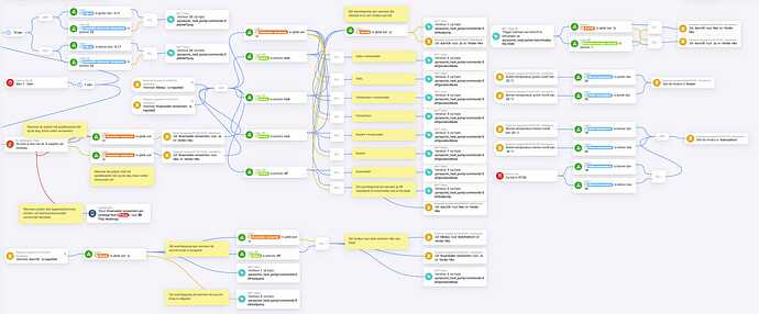

If anyone wants to know the flows, Sorry the notes I put in while working are in dutch.
This is just to set the correct data inside the device:
Summary

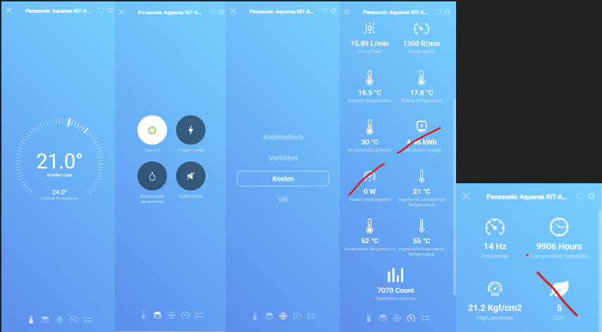

The temp setting:
Summary

Setting the heatpump mode:
Summary
Quiet and Power mode:
Summary

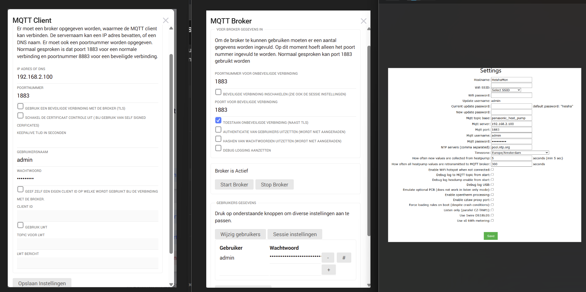

The settings for the heishamon, And MQTT Client/Broker:
Summary

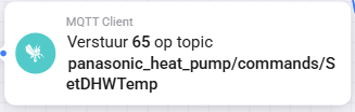

You can send variables through the heishamon(If you use the correct connection cable) with these(These are the once I found and used. I think there are way more, but I don’t know them):
Summary
panasonic_heat_pump/commands/SetOperationMode
panasonic_heat_pump/commands/SetHeatpump (0 heatpump off, 1 heatpump on)
panasonic_heat_pump/commands/SetPowerfulMode (0 off, 1/2/3 are the amount of time powermode is on (30/60/90 minutes) (If I remember correctly))
panasonic_heat_pump/commands/SetQuietMode (0 off, 1/2/3 are the levels of quietmode)
panasonic_heat_pump/commands/SetZ1CoolRequestTemperature (Just send the temp you want it to cool to)
panasonic_heat_pump/commands/SetZ1HeatRequestTemperature (Just send the temp you want it to heat to)
panasonic_heat_pump/commands/SetDHWTemp (Just send the temp you want it to heat to)
Example for setting dhw:
