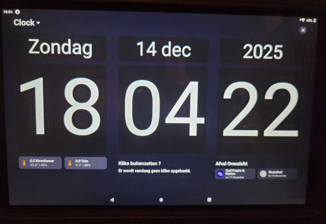

What HTML files have you added to the dashboard? Is it only a static HTML or does it use JS to fetch more data from a server in your LAN?
Just a clock. nothing fancy :
I can miss that when not at home, it’s for a dashboard in the livingroom…
