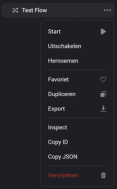

I learned that in the web app, when right clicking an Advanced Flow or Standard Flow and simultaneously holding the ALT key, the context menu gets some additional items:
The Export option creates an .homeyadvflow text file for an Advanced Flow (.homeystdflow for a Standard Flow), containing (I assume) the flow definition.
I haven’t been able to determine how you would import this file (restore the flow) in the web app. Anyone any suggestions and/or experience with this functionality?
EDIT - I found it: right clicking the My Flows header when holding ALT brings up an Import Flow option. And it indeed restores the exported flow:

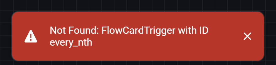

Upon import I get the following error:
Note that I have a Homey Pro 2023. If I am correct you have a Homey Pro 2019. Maybe some flowcards are not exactly the same under the hood. In this case the ‘Every x days’ WHEN card.
I checked the contents of the file for the trigger card by also creating a Standard Flow with the same Every 1 Day trigger card:
  • Yours : “trigger”:{“uri”:“homey:manager:cron”,“id”:“every_nth”,“args”:{“n”:1,“type”:“day”}}
  • Mine: “trigger”:{“id”:“homey:manager:cron:every_nth”,“uri”:“homey:manager:cron”,“args”:{“n”:1,“type”:“day”}}
The syntax used for the ID of the card in the file differs.

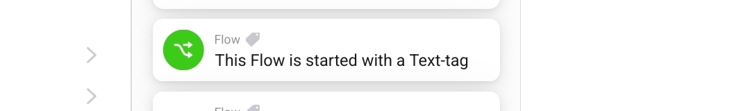

I replaced the trigger with a “Flow started with a text tag”
Can you try again?

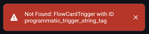

Unfortunately also not. I get the following (different) error:
I think you are using a tag in your flow of an app that is not installed on my Homey. Most likely the ‘Zonnenstanden’ app you are referring to. I assume the ‘Seizoen’ and/or ‘Current Season’ tags.
So that suggest that you need to have all apps installed that the flow uses. Which makes sense, though the importer leaves you in the dark as to what apps are missing. Would be nice if the importer would create a ‘missing dependencies’ overview with the human readable names of apps and tags.
No it’s the triggercard, a flow trigger with a string tag, like the error says. I tested with Homey Cloud, same error.
I changed the trigger to several other “standard” things, but importing @ Homey Cloud fails on the triggercard every time, I think it fails @ Pro23 as well.

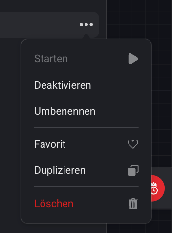

These features are not available on my MacBook… :cry:
You mean you don’t have a rightclick and no Alt-key ?
Maybe refresh your browser so that it loads the latest version of the web app.
Of course, I have both an ALT key, which is called the “option” key on a Mac, and a right-click. But when I do this action on the three dots next to the flow name, only the “old” context menu opens:
@SunBeech, a refresh doesn’t helped. I have also tried different browsers, Safari and Chrome.
Maybe on Mac a different combination is needed, using SHIFT, ALT/option and/or CTRL/control keys?
Nope, tried already every kombination I know of.
Hi Dirk, it works on my MAC with the opt key. Did you try refreshing the page?
Ahhh, I figured it out. First, you have to right-click on the three dots and then press the option key. Until now, I had been trying it the other way around or simultaneously, but that didn’t work.
