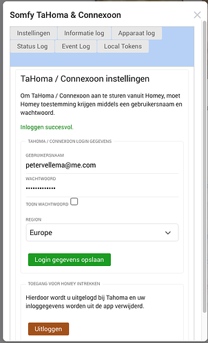

I get a similar error as Ger-van Lierop with the Homey Pro 2023 and Somfy Tahoma. (in Developer Mode)
The TaHoma & Connexoon App for Homey is installed. User name and password are correctly filled in.
When I add a new device I get a error messages:
(example: Verticale buitenzonwering (io) )
“connect econnrefused 192.168.50.27:8443”

Could you try restarting the Somfy bridge and the Homey app to see if that helps.
I restarted the Somfy TaHoma Box and the Homey app but still get the same error when I add a new device:
“connect econnrefused 192.168.50.26:8443”
(only the IP adress is changed)
Hmm, I’ve not seen the connection refused like that before.
Can you open the local tokens tab, thenn tap on Get Tokens to see if any tokens have be generated.
