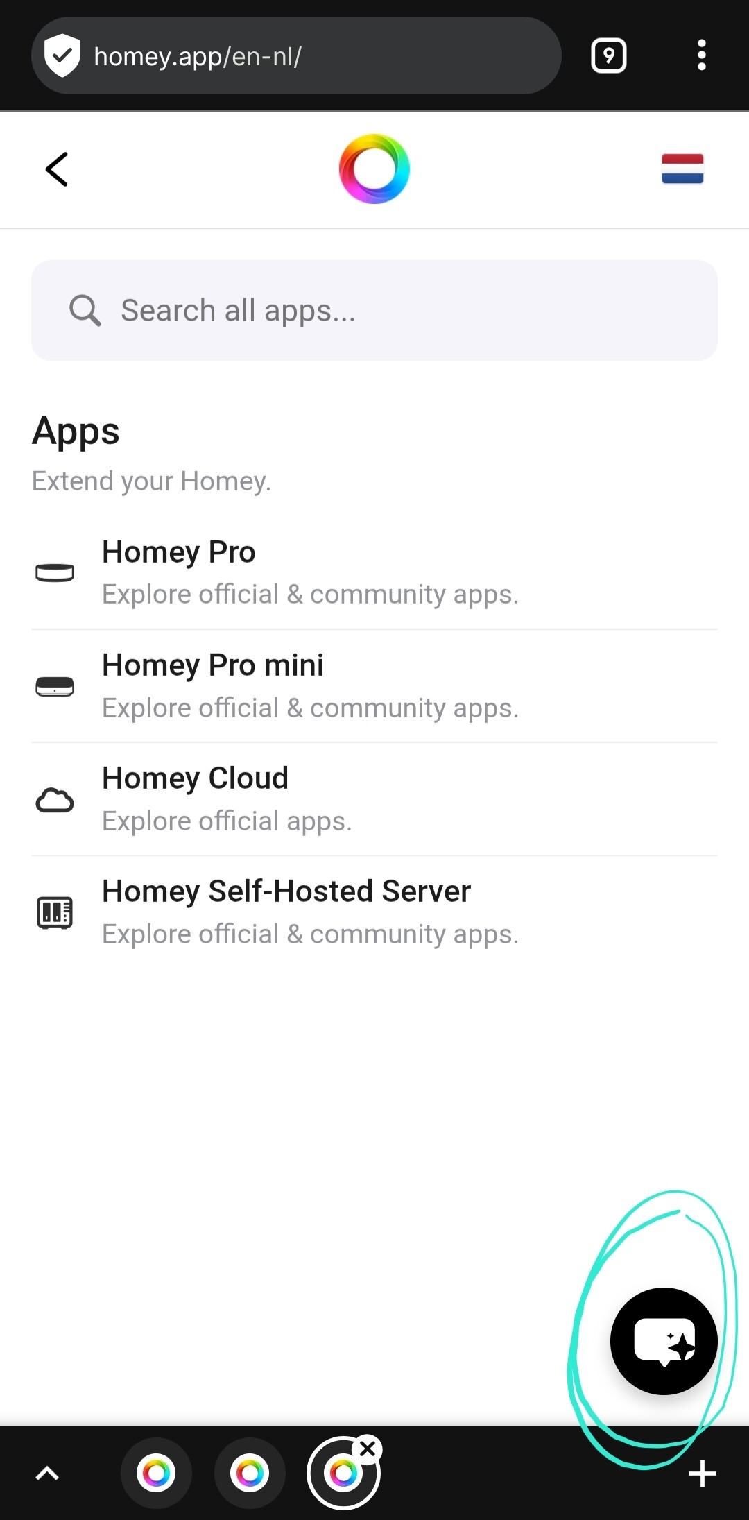

You can try asking Homey bot? Who knows..

Thanks, was not aware of this. I’ll give it a try
Thanks again. Very useful function. The result was however that it is either that the Vesternet driver does not support direct associations at all, or a security level mismatch. It suggested re-including the fibaro device in unsecured mode. However, I don’t like messing around like this in general, so hope that the Aeotec controller has the right security and driver… Funny that the 8 y old simple wall controller with its old firmware works like a charm…
