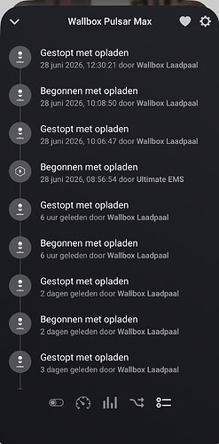

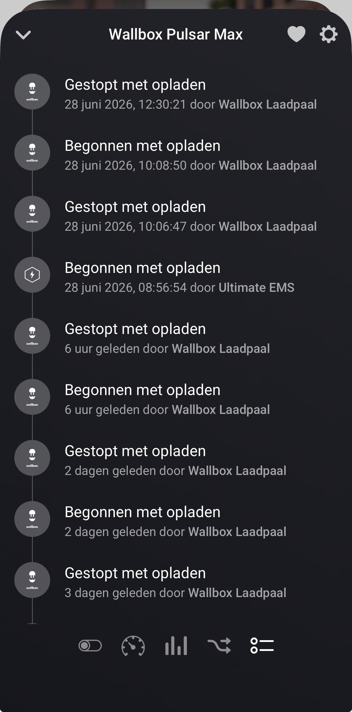

  3. Screenshot of the Wallbox device — open the Homey app, tap on your Wallbox Pulsar Max device, and send a screenshot of the full device card showing all the values.

Goodmorning! :wink: all should be fixed. There was a difference in how the wallbox and the tesla were sending the states back. One side note, your PV is putting out a negative power, is this on purpose?

This morning around 9AM my charger started based on an EMS command, while there was not enough surplus. This resulted in unneccesary net usage.

Hi Arjen,
Thanks for the detailed bug report. I traced through the code and have a question before I dig further.
In your current bug report, ev_charge_mode is set to "pv" (solar only). In that mode, the EV controller only starts charging when solar surplus ≥ 3450W — grid charging is never triggered, regardless of price.
At 9AM your PV was around 500–900W, so "pv" mode would never have started the charger.
Did you change your charge mode to "pv" after the incident this morning? Is it possible it was set to "solar_and_grid" at 9AM? In that mode, the EMS will charge at minimum current (5A) whenever there’s any meaningful solar output (≥200W) and prices aren’t expensive — which would explain exactly what you saw.
Also: did you have a trip scheduled with a departure around 9AM?
I did not switch the mode, and also don’t use the trip planner yet. The solar power is only a small part of the PV generation, while two inverters are dumb and therefore not possible to connect to Homey. I had CT’s, but couldn’t get this to work properly. You get a better picture from the diagram below.
What’s also strange is that in the dashboard, soc shows 0%, while Homey shows the correct 100%.
Hi Arjen,
Good news — after tracing through the code, this is actually correct behavior, not a bug. Let me explain what happened.
The EMS doesn’t use the measured PV output (your Hoymiles) to determine solar surplus. Instead, it reads the net export from your P1 meter using this formula:
surplus = -gridW - 100W buffer
Your P1 meter sees the combined output of all your inverters — including the two dumb ones that aren’t connected to Homey. So at 9AM, even though the Hoymiles only showed ~900W, your dumb inverters were likely adding another ~2600–3000W on top. The P1 was showing something like 3500W export, which pushed the surplus above the 3450W start threshold (5A × 3 phases × 230V).
The EMS correctly saw “enough solar surplus → start charging.” This is actually the right approach — it doesn’t matter where the solar comes from, the P1 tells the full truth.
What likely happened then: your dumb inverters dipped slightly (morning sun angle, brief cloud), export dropped below the stop threshold, and during the hysteresis window (a few ticks before the EMS stops) there was brief net import. That’s by design — rapid on/off cycling would be worse for the car and charger.
On the SoC showing 0% in the dashboard: the ACCU tile shows battery SoC (you have no battery, so it shows 0%). The EV SoC is shown separately in the EV tile. I’ll check if the label can be made clearer.
So in short: the EMS works as intended — your dumb inverters’ production is “invisible” to the EMS as measured PV, but fully visible via the P1 export. That’s exactly why using the P1 for surplus is the right design.
Appreciate the try, but this most likely was not the case. At 9AM it is impossible that my PV on west and south orientation generated enough for 3450 export during this period of time, also because an airco and heat pump are pulling around 800 watt 24/7. You can also see this in the diagram, before 9AM export was around 1,4kW. So it’s more likely it triggered based on single phase, while my setting is three phase.
Concerning the soc, that makes sense. :wink: Wrong assumption from me.
