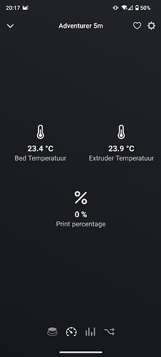

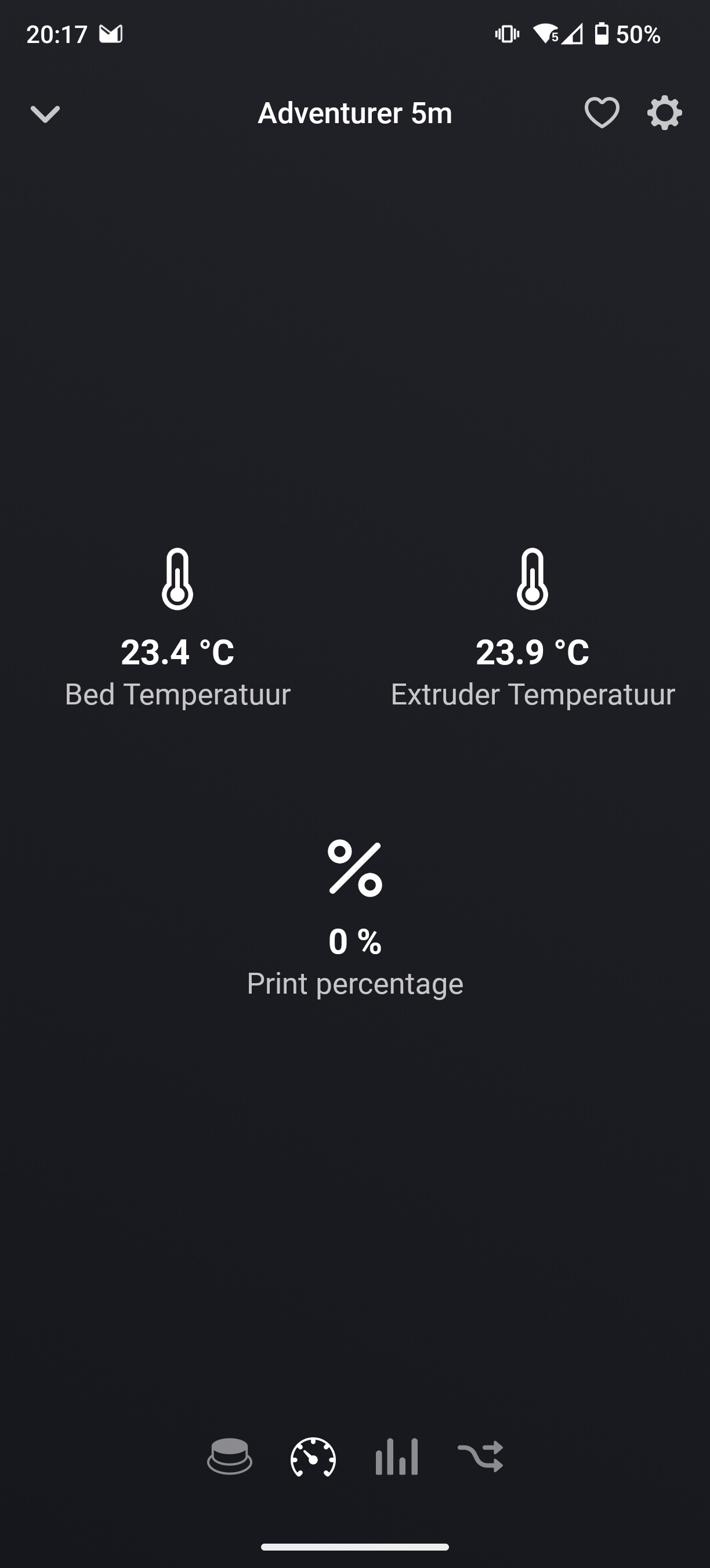

So i made the onoff button capability with getable: false, and setable: false. The quickaction is disabled, and in the interface you get this:
Which does nothing as i registered an empty listener, isn’t this a bit confusing?
I also added the print state as a sensor ( still need to work out icons somehow ):

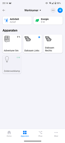

On the homepage its like a sensor, no button press here:

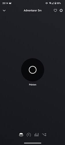

when you go “in” the device, you get the printing button, which changes state if the machine is printing, or pauses/resumes if you press the button

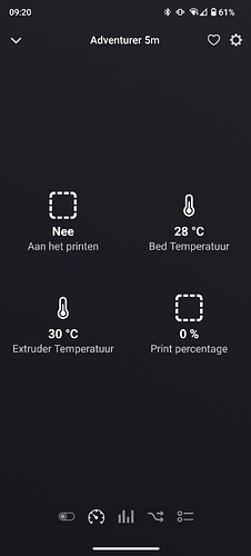

And on the sensors you have this:
I am definitely no UX’er, but I have the feeling this is working properly.
What do you think? Any remarks?
