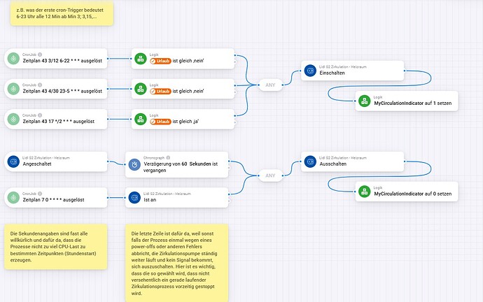

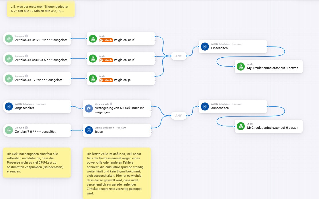

How do you acheive that you want to turn on a socket for X minutes and then off for Y minutes?
Like on for 10 minutes and off for 40 minutes, and then repeat for infinity
Use a timer app like chronograph.
Great! Will try that. Thanks!
Sounds like a job for the loops app
