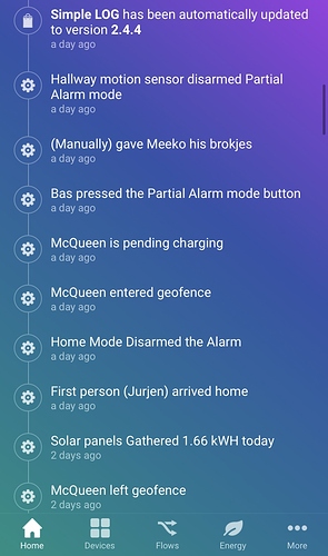

Hi!
Since the last update my log entries in the timeline are also showing the Log Group name. I prefer the old way where the simple log logs show the group name but the timeline only shows the entry. Is this something that is by design now?
Before the latest simple log update the time line looked like this;
And after;
Hope this is something that can be reverted
Guess I never pushed that update in the meantime. :grimacing:
I’ll make a new card for it. Or add a checkbox if possible to the existing cards
