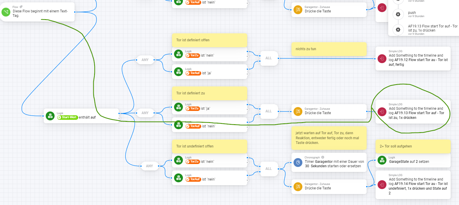

this is the timeline to be read vom bottom to top
this is flow AF20 and it is startet with
so first log should be AF20.02
now flow 19 it´s triggered
this is doing two things:
  1. message AF19.13, which is in the timeline the first.
  2. press the button which is in flow 20 and creates message AF20.01
any idea?
Well, yeah, in your second image, you show to FIRST start flow AF19 (and wait till it’s done) and after that’s done, you write AF20.02 to the timeline.
Within AF19 you write AF19 to the timeline, which will be executed before AF19 is done, so before AF20.02 is written to the timeline.
But i have the feeling you expect AF20.02 to be written first?
If so:
  • Disconnect the current line from the start card (from image 1) to “Start AF19”.
  • Connect the “Add af20.02 to timeline” to the triggercard from image 1.
  • Now, reconnect the trigger to “Start AF19”.
By connecting start-AF19 and timeline-AF20.02 both to the trigger “Angeschaftet”, the will run “at the same time”, so AF20.02 should be logged before AF19 (since the Start-a-flow card waits to finish the started flow i believe, if i am not mistaken. If not, use my Advanced Triggers app.
The reason for the disconnecting and connecting? The next flowcards get executed in order that you appended the lines, so, by connecting Timeline-AF20.02 first, you make sure that Homey tells the flow to start executing that flowcard first, then the AF19.
Hope this was what you wanted.
And, are you on live or test version?
Thanks a lot. Understood the logic now. The log card was only fired after the flow 19 returned.
