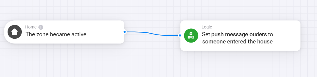

Maybe I have a solution (which I use, but it is not working for guests). I have a variable with the name push_message_all created in logic. The I have the following flows.
IF variabele push_message_all has changed
THEN for every user a card to send a push message with the tag from the push_message_all variabele
Then for every flow where I want to send a push message to all the card in the THEN column "set variabele push_message_all " with the text in it which you wanna send…

@Patrick_Van_Deursen
I think I might not have understood Marc’s explanation correctly. However, since it seems that you did, could you probably share a screenshot or two of how you set the variable and included it in a flow?
Thanks a lot in advance!
and
Awesome, that helps a lot — I’m more of a visual learner! :wink:
