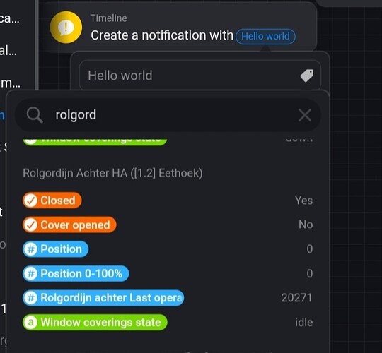

In the textfield of the notification: if you click the tag button and fill the device-name in the searchfield, what tags are listed?
There are no tags. That’s the whole thing :slightly_frowning_face: I added my screens through matter. I can see the status of the screens and the percentage they are closed/opened on Homey. I want to use logic to have a better overview and to make it easier for myself for creating extensive Flows

When there’s capabilities in there, there should be tags as well ( in theory :wink: )
Goedemorgen/Goodmorning @Peter_Kawa
This is the list of capabilities one of the screens have. I’m just wondering how to implement them using tags (to identify them independently)
Just to be sure, you are using the timeline card? (the timeline cards are missing in your initial flow). I don’t see any reason why tags in the timeline card wouldn’t show any capability for the device (as Peter_Kawa screenshot shows).
To identify them independently you’ll have to make sure you select the right one (in Peter_Kawa screenshot it shows the device "Rolgordijn Achter… "
