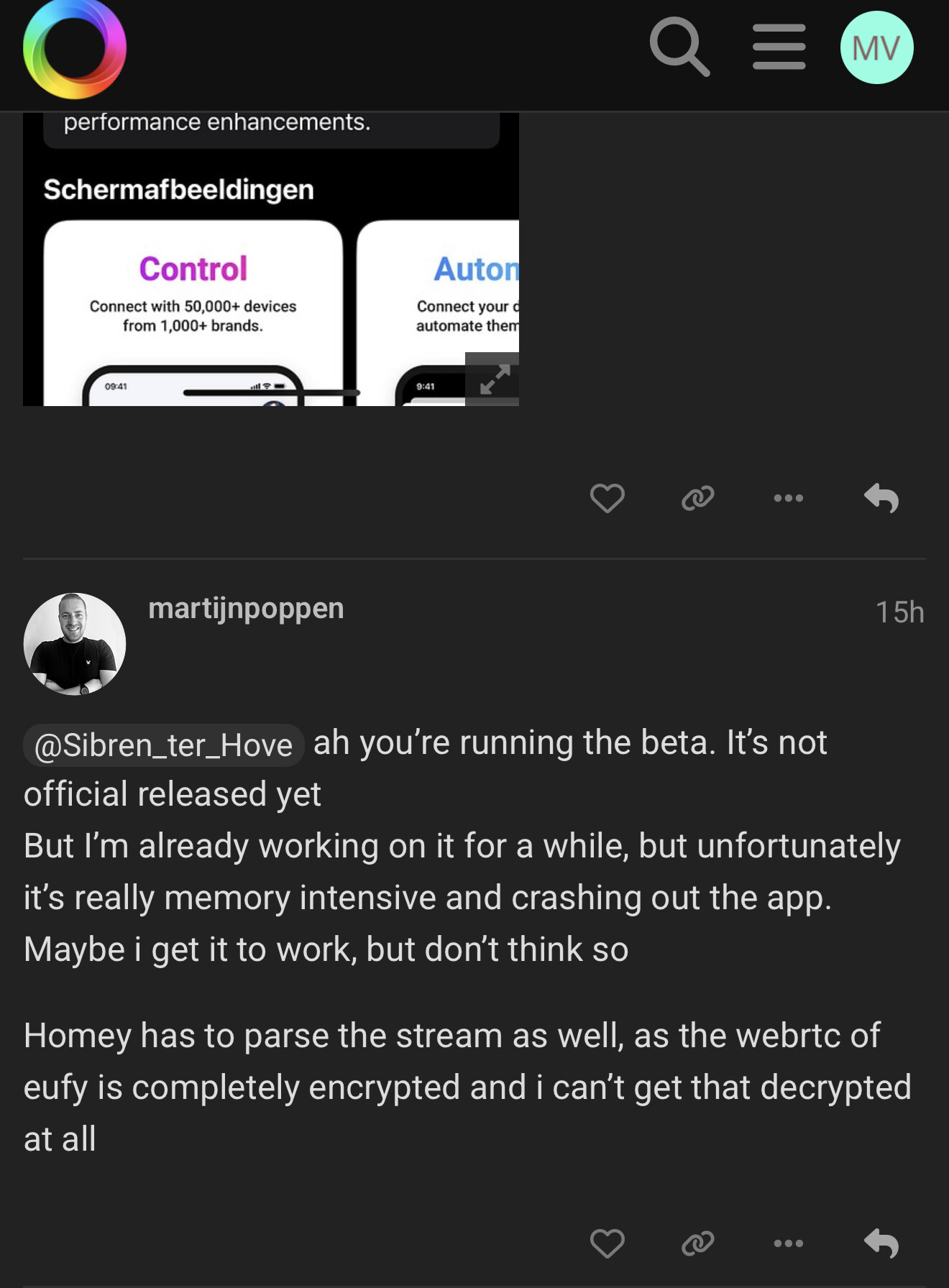

@Doekse can I find somewhere the instructions to test the camera streams? (Which brand is already supported yet)Because@ Martijn poppen said that he working on the implementation but he can not implement yet because the encryption of Eufy ?!

@robertklep not my words…
See Eufy tread or the reaction of Martijn ..

I don’t see the connection between being able to test streams and the issue that @martijnpoppen is trying to solve for the Eufy devices.
In any case, from what I’ve seen in the SDK documentation, the current video implementation basically just passes video stream URL’s to the Homey app and there is no way to parse/process those streams from an app.
@robertklep yes that’s correct.
Only video urls are supported. There’s a VideoOther integration, so in theory you can run your own http server (specified as video/h264) inside a homey app on a open port and then go to that url in the video stream.
(That’s currently what i’m trying for Eufy.)
However as you already mentioned: “Does Homey have enough resources for transcoding then?”
Answer to that is no ..
Testing a stream and then start another crashes out the app.
The transcoding is done in the Homey app, parsing a H264NAL stream to the http server, but actually you want something like FFMPEG to run this properly
