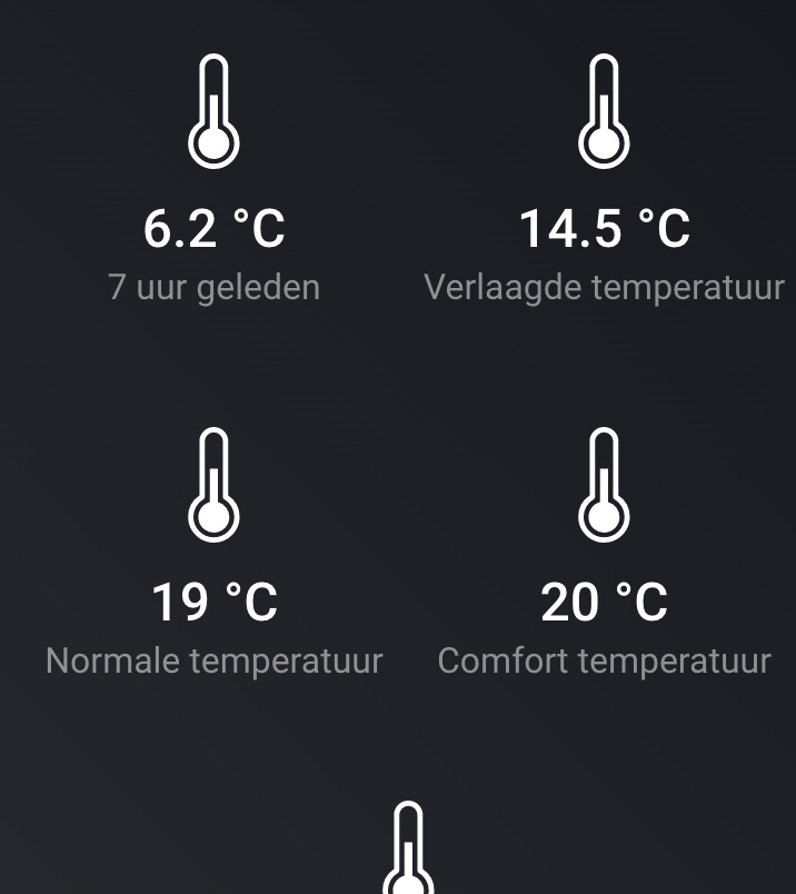

I’m querying an api to get the latest reading from a thermostat, but the latest readings do not appear in the app. When I check the readings, it say that it was updated 4 hours ago (even if the data is queried every minute)

I’ve added the inspector to the code, but in the background the routines are still running and returning the correct values.
It looks like the values are just not being updated in the interface, but I have no clue why it is not working.
I assume that other apps are showing their updated values in the interface?
They are indeed updating as it should.
I also did a PTP on the Homey but that did not resolve the issue
Perhaps ask around on the #developers channel of the Homey Community Slack.
I think I found the issue, when adding a await in front of the this.setCapabilityValue this issue got resolved.
