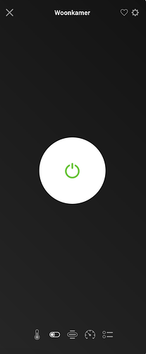

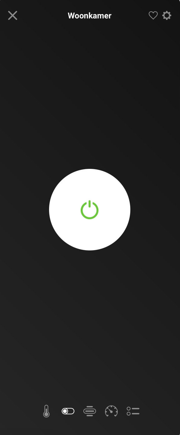

Send screenshot of device in homey app
Ok, you have send it previously.
The device has a separated button for on/off
Yes it has an on / off button next to the mode selection
if the thermostat is off, the capability onoff is true?
if the thermostat is on, the capability onoff is false?
the other way around.
ON = TRUE
OFF = FALSE
