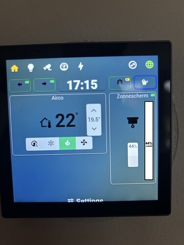

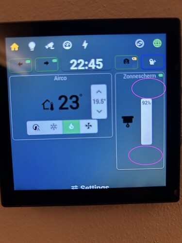

For user convenience can you do a bigger slider for blinds ?
The slider size is under 30% of the total widget sizeā¦
Very hard to put blinds on 50% for example.
It would be nice to have the slider as high and low as possible. Then itās easier for users to set a value.
In my example I have to make the widget 3 high to have a slider that is controllable on a NSPANEL screen. On smaller widgets itās not workable.
yes, i can

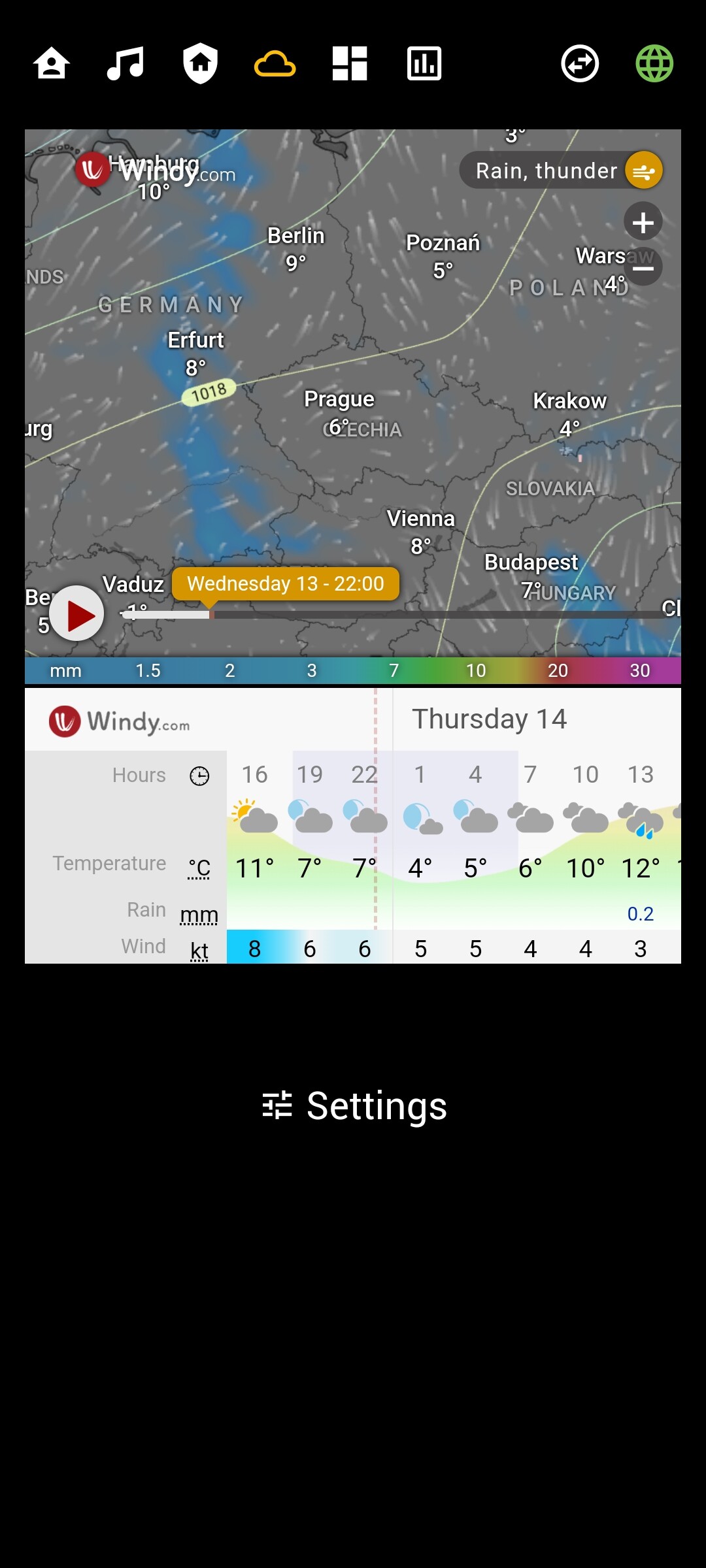

I just experimented with iframe of windy.com, really cool weather forecast with about 10 visual overlays. The map may be set to any location / country. The problem is that while the iframe with weather allows me to roll the days to the right, I cannot press play for the meteoradar animation or switch the overlays. Windy.com has its own javascript api, maybe you may want to consider itegrating it, it would provide a beautiful weather forecast to anybody and I assume that the api will allow for more customization than to call the iframe.
BR
Tomas
Hi this is because i have deny operation in iframe. I can option for enable it (maybe it can be unlocked by css rule
Vertical slider is more complicated to manage because itās a horizontal slider rotated and need some alignment for nspanel, portrait and landscape layout

Yes, you can interact with the iframe with a css rule:
.content iframe { pointer-events: auto }
I have update second post of topic with the complete guide to CSS and grouped some usefull CSS rules
you can fix with a custom css rule (attention, it work good with a 1x3, if you change dimension need some adjustment)
.content .range.v { width: 300%; left: -100% }
