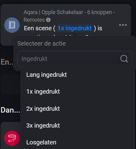

You have the Aqara app?
If you want al the buttons seperatly you have to choose for “a scene has been activated”
Then choose for button 1 and 1x pressed.
Now you can go to then and do want you want with it.
Turn on or off what ever you want.
This works for al the six buttons.

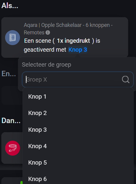

For the WebApp
or this :
Button 2, pressed 1x Example for button 2.
Then you can use 6 buttons.
