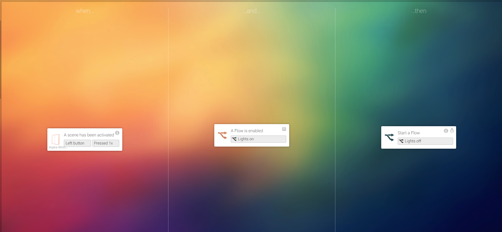

For some reason i cannot figure out how to set this Flow up. Have two working flows (Lights on and Lights off) and i like to connect them to an Aqara wireless remote switch double.
What i want: Press left button to turn light on. Press it again to turn light off.
Have set up two flows now but is seems they are conflicting with eachother. Can someone please help me/tell me what i am doing wrong?
and

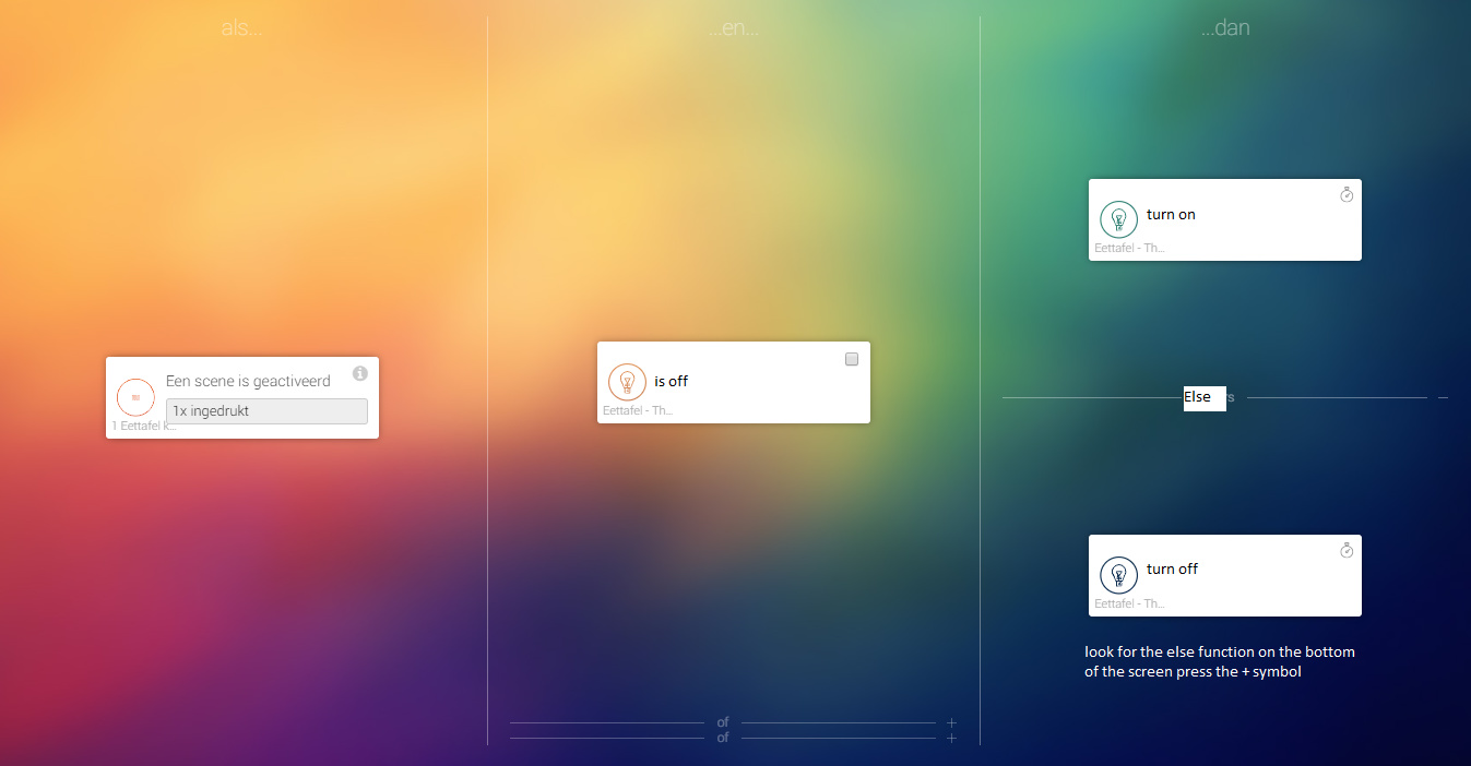

I think you should use only one flow and use an ‘else’ in the ‘then’ column. If that makes any sense… :grinning:
So something like this:
When left button pressed -> and Lights are of -> then lights on else lights off
like @DrDoom said except now with a picture
hope this makes things clear!
