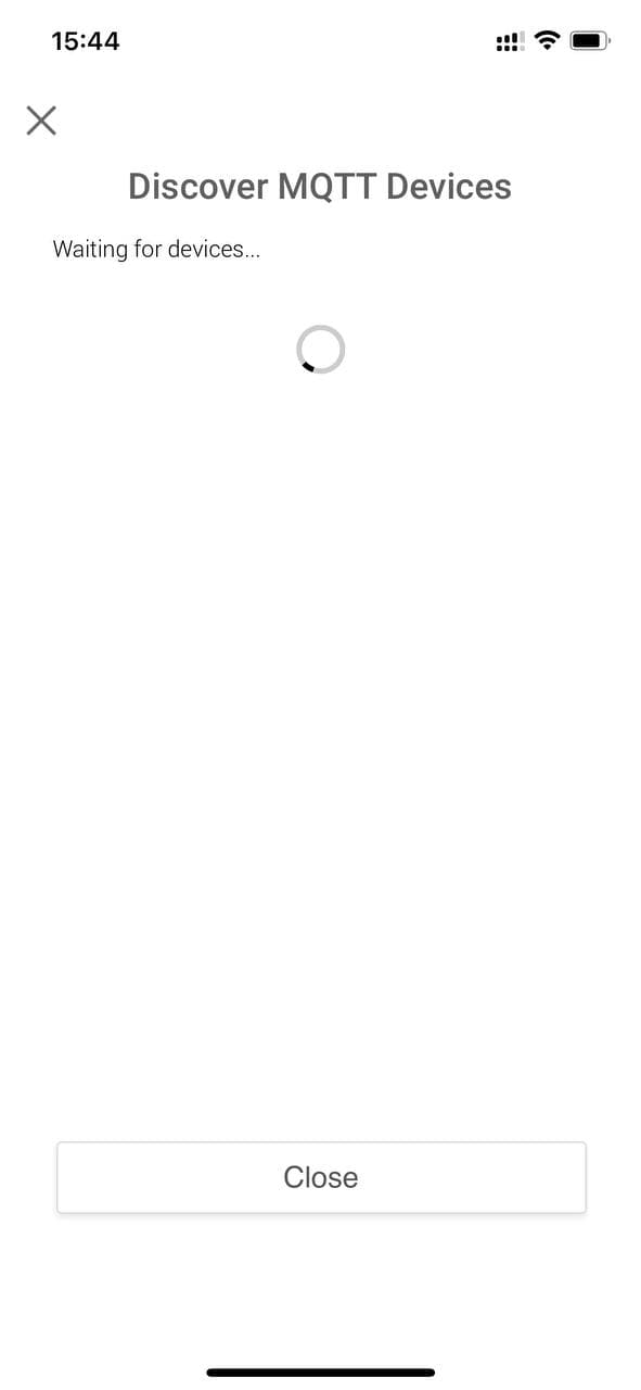

For some reason Home Assistant Discovery function doesn’t work for me.
I have only one motion sensor. I was able to add it manualy, but not using Discovery function. Please help.
Screenshot_1
