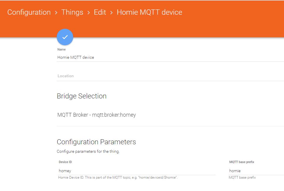

seems like im running into a similar problem as @Camelen however for me it doesnt appear online or show channels as soon as i restart/reinstall the gateway app.
Is there something about the credentials that i use for OpenHab / MQTT Client or the device / client ID’s that have to be configured that i’m missing?
DeviceID is the name of your Homey ‘nomalized’.
