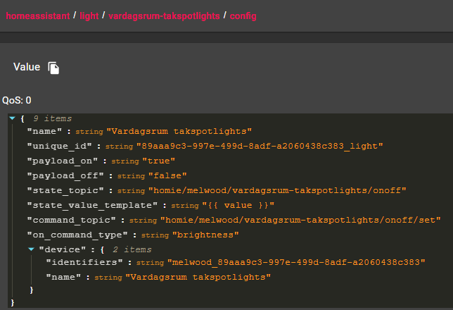

I´ve set up a connection to Home Assistant without problems. Homey devices are discovered, but I´m facing some difficulties controlling lights that are simple on/off (without dim). I suspect it is related to the “on_command_type” topic. It seems to be configured to use “brightness” instead of default “last”. Thus only brightness command is sent instead of payload_on to turn the light on.
I haven´t had time for more thorough testing so forgive me if I´m wrong on some point. MQTT-explorer snapshot and Home Assistant link below for reference.
on_command_type
(string)(Optional)Defines when on the payload_on is sent. Using last (the default) will send any style (brightness, color, etc) topics first and then a payload_on to the command_topic . Using first will send the payload_on and then any style topics. Using brightness will only send brightness commands instead of the payload_on to turn the light on.
@Gustav_Tillback You’re probably correct. on_command_type is set to ‘brightness’, because another user reported non working devices due duplicate messages with the ‘last’ setting (2 messages are sent, dim & onoff).
What I’m going to try: for devices with device class ‘light’ the setting will become ‘last’, for other devices with dim capabilities (e.g. sockets) it will remain ‘brightness’. Hope this will work for both parties…
@xAPPO this will probably solve your issue with the onoff state to.
