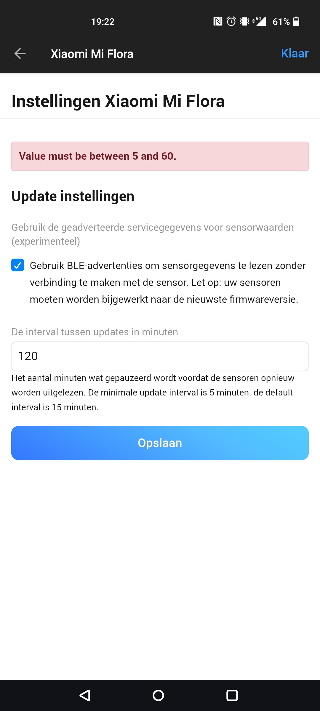

Which interval, can you share screenshot?

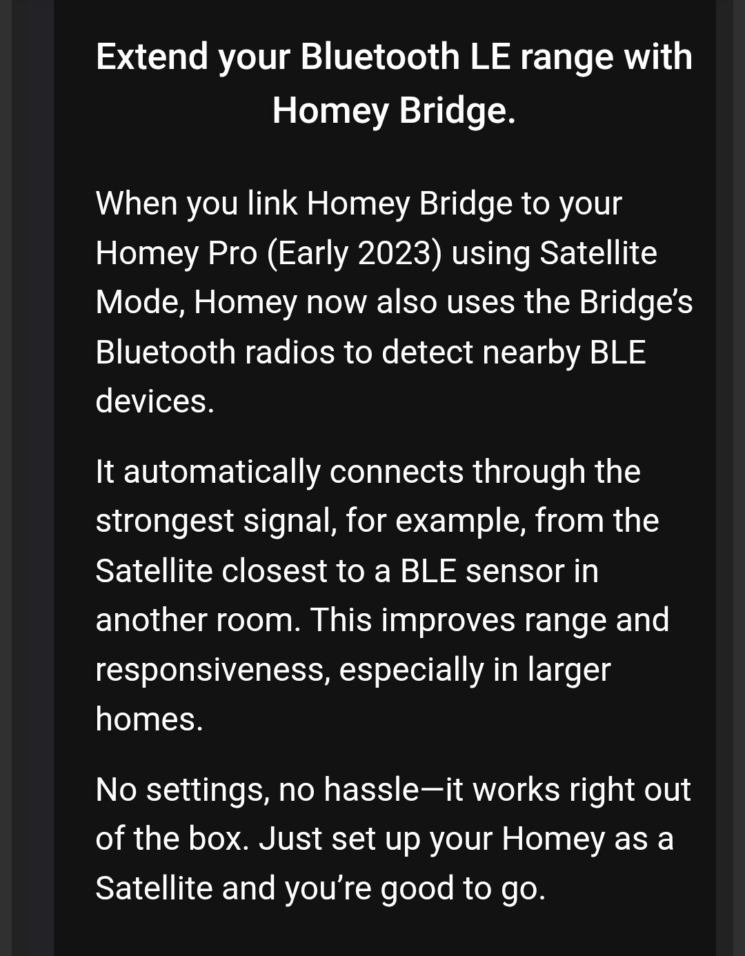

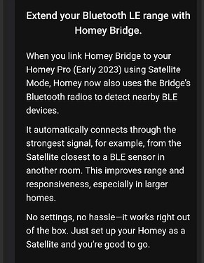

I do have a homey bridge as satellite but I don’t remember anything about ble through the satellite. Is this configurable?
It’s automatic, Homey is supposed to evaluate signal of the device and connects trough next route, if I’m not mistaken
When using advertisement, it reads what Xiaomi send in regular intervals, every 5 min - there is no way how to influence that client side behavior on Honey side. Please set the interval to 5 - 15 min to check if that’s make any difference.

I think/expect it’s similar to the functionality with IR & 433MHz, but the KB article isn’t updated with Ble info yet:
