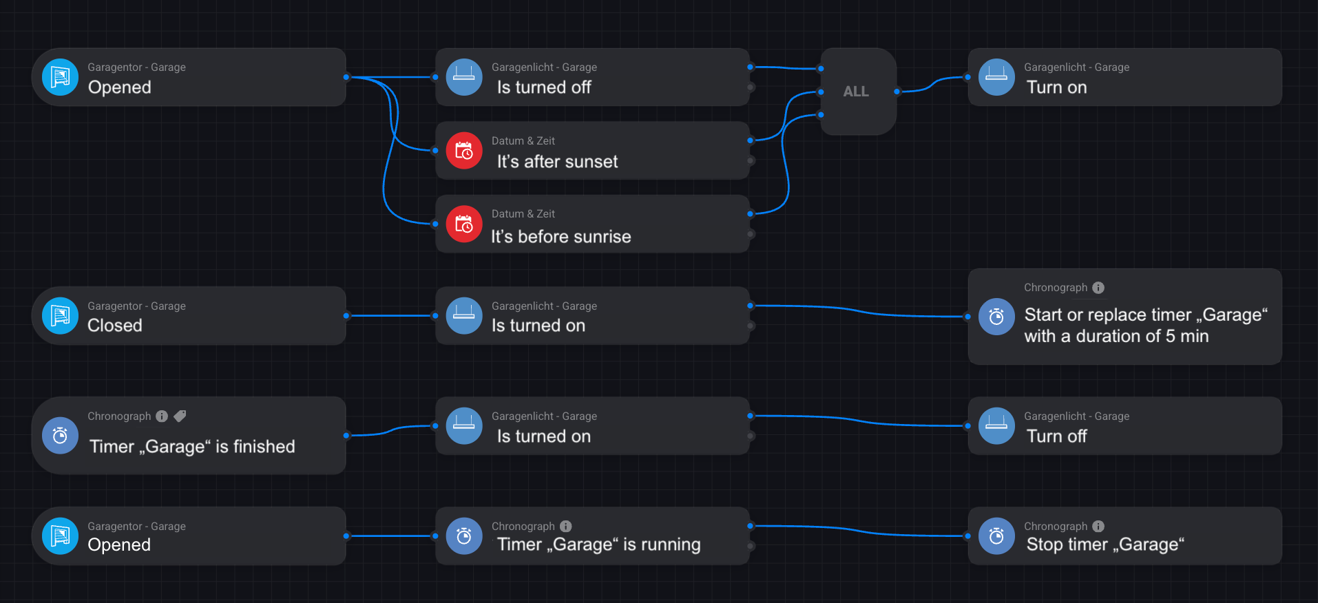

Instead of using an internal delay flow card, I recommend using a timer app.
The advantage of timer apps is that it’s possible to stop the timer, e.g. if the garage door is opened again within the 5-minute delay. This is not possible with the internal delay card!
Example (internal delay card):
  1. Garage door is opened → light is switched on
  2. Garage door is closed → 5-minute delay is started
  3. 4 minutes later, the garage door is opened again → the light will be switched off after 1 minute, even though the garage door is open
This is an example using the Chronograph app:
I also included Wim’s suggestion that the light should only be switched on when it is dark.
To do this, I used the internal “Date & Time” flow cards, which refer to sunrise and sunset. Of course, you can also use a light sensor as a reference.
You don’t necessarily have to use the Chronograph app, it should also be possible with other apps, such as the CountDown or FlowBits app.
