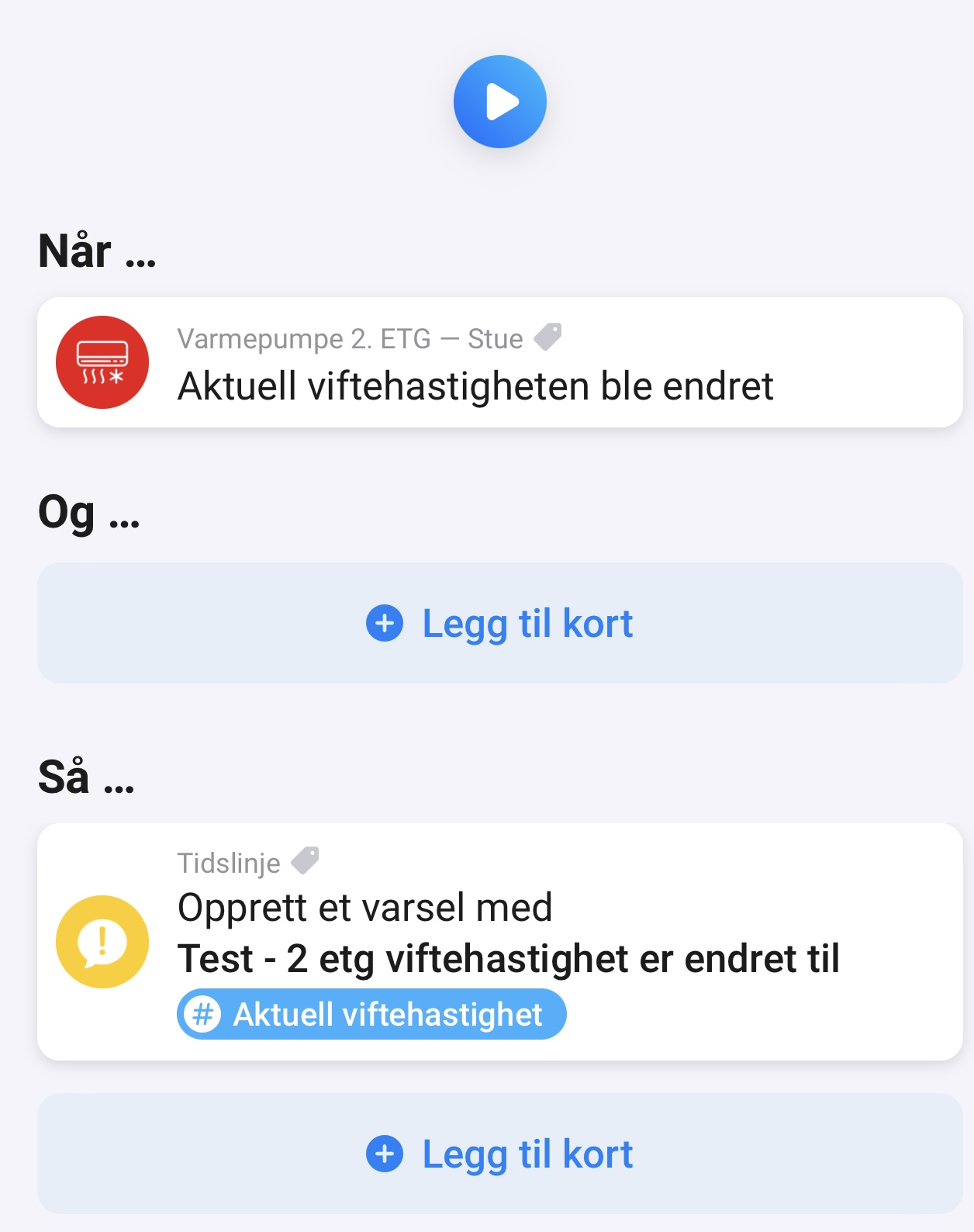

Thank you very much for the app. I have a minor issue when using change of actual fan speed as trigger. I am trying to use it to detect de-icing of the outdoor unit.
I have configured a simple flow who starts and writers the fan speed to the timeline, but it never triggers. The change in fan speed is logged in insights and reported correctly when the flow is started manually. Maybe some delay from Melcloud?
Kind regards,
Mathias
Hi @Fiffus, can you screenshot the workflow you configured, so I can understand better?
Fan speed and actual fan speed are not synced, and there’s a delay between both, on which the end user has no control since it’s controlled directly by the heat pump system.
@Fiffus, I’ve found the bug, will fix it in the next release.
Hi. Hello. Good. Thank you. The screenshot is in Norwegian. I just use “actual fanspeed”.
I think use of this trigger to count number of de-icing cycles can be quite useful to power on another heat source after x cycles to prevent ice building up.
This will never trigger. But works when manually started:
