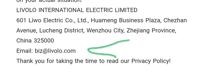

I wrote what I wrote, because:
  1. To me this seem issues only the app developer can fix
  2. I found their email address in China in 2 seconds, following the support link. I assumed you can do that too :grimacing:
    So the support link is, imho, not entirely useless as you stated :wink:
OK here is an update, they did reply when i sent an email to the business development email address above. Turns out you have to setup your livolo gateway to their Asia cloud NOT the europe one for the homey integration to work.
