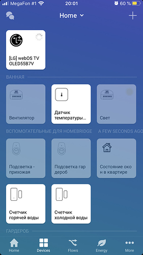

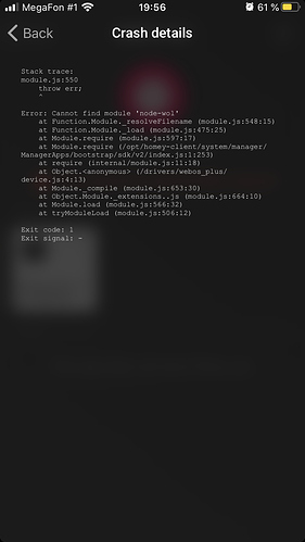

Hey. The application installed normally. There were problems adding a new device. The application cannot be verified from the application. There is an error in the application itself. I attach all the photos.
Try running npm install before installing it on your homey. It looks like it’s not installing the dependencies.
Hi installed through NPM INSTALL, but unfortunately all the same errors. When you add a TV, it is added to the TV’s icon and then the download status, as if looking for something, then shows an exclamation mark, and then again looking for something. The TV itself, after adding to Homey, does not offer to create a connection with the application.

Hi @Tolga, I debugged this in a private chat with @Evgeny_Grin. It appeared to be an issue on his side where the dependencies wouldn’t install. If you get a message that some package could not be found… please check if you ran npm install before installing it on your homey and that the node_module folder is created and has content. If this is the case and it still isn’t working, please contact me in a pm so we don’t spam this topic :wink:
