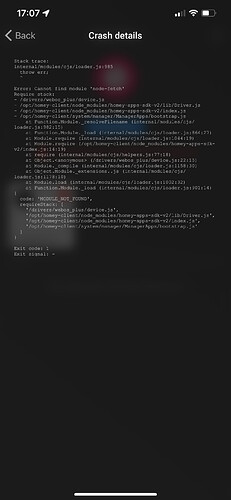

Haha yes i did that but now everything crashes
@MaxvandeLaar Hi,
I updated from 2.1 to 2.3 and now everytime the app crashed. Go back to 2.1 and everything is fine. Only for your info @MaxvandeLaar
Many thanks! It works nicely here. I will monitor if I get more crashes.
@Tolga are you experiencing the same crashlogs as @JB2K?
@JB2K how did you install the update? Was it automatically installed via the HCS, or did you do it via commandline? in case of the latter, run npm install before you install the app on your Homey and it will fix the issue. I am unsure why, but the app always seems to have an issue with node-fetch.
Hello @MaxvandeLaar ,thanks for your help, npm install solved the problem. Big thanks for your help. Great Job
