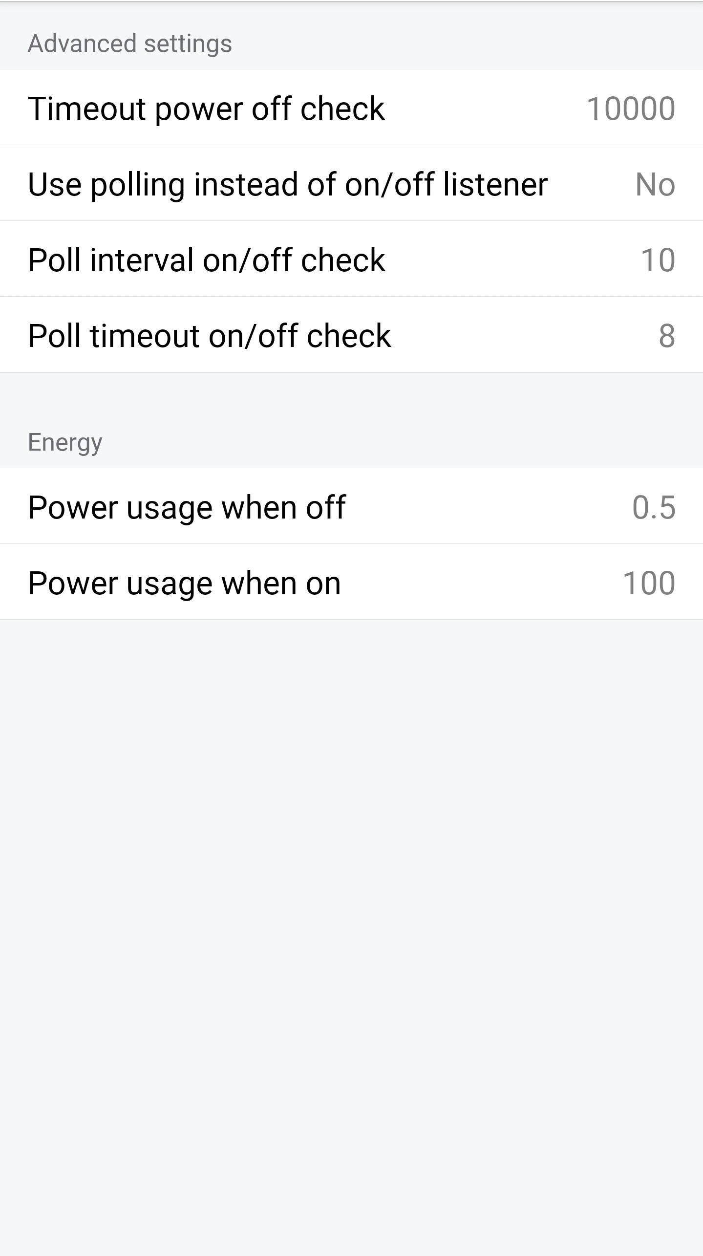

I have some issues with the “state of the device”. Homey can’t identify when my television is on or off. Sometimes I’m watching a movie and Homey thinks that the television is off. I’ve found the advanced settings, but I don’t know what settings I need to update/change. Some suggestions/tips are more than welcome!
Homey version: 4.2.0
WebOS Plus: 2.2.1
Television: Oled55C8
Software television: 05.30.02
Hi @SejoerdO,
Can you share your current advanced settings? That way it is easier to give advice.
Hereby a screenshot @MaxvandeLaar
I hat to set “Use polling…” Yes for my setup.
I will try this and keep you updated.

@SejoerdO,
So after I explained how this works to someone else before I noticed I choose horrible labels as it can get a bit confusing; sorry for that :wink:
So how it works… (the dumbed down explanation)
The TV sends messages to my app when it powers off. However, what kind of messages and the order they are send differ almost per TV and software version. It is a bit chaotic.
This can be controlled by the Timeout power off check. By setting it to 10000 it will tell the app to wait 10 seconds after it received an ‘Off’ notification from the TV to set it to off in the app. This is due to the strange order of the notifications. For example, I sometimes receive an TV is off notification and after that a TV is going in suspended mode… while the actual order is suspended (but the status of the tv is still active) and then it turns off. The code for that looks like this:
      timer = setTimeout(() => {
        this.log(`_powerStateListener: Called timeout`, status, processing);
        //Screen saver(?) should tv be turned on?
        if (((status === 'active' || status === 'screen saver' || status === 'screen off') && !processing) ||
          (processing &&
              processing.includes('on') ||
              processing.includes('ready') ||
              processing.includes('resume') ||
              processing.includes('saver')
          handleOn();
        } else if ((!processing && status !== 'active' && status !== 'screen off') ||
          (processing && (
              processing.includes('standby') ||
              processing.includes('suspend') ||
              processing.includes('off')
          handleOff();
        clearTimeout(timer);
        timer = null;
      }, this.getSettings().powerStateTimeout || 2000);
Some TV’s actually never send these notifications or only partially. Therefore, I also implemented the possibility to use a simple network polling method.
If the Power off check is not working for you (which it isn’t in this case) you can set Use polling... to Yes.
Now the other to params come into play.
The Poll interval on/off check is simply the interval the app will poll. So in the default case it will check if the TV is on/off every 10 seconds and it will give the TV 8 seconds (Poll timeout on/off check) to tell it’s alive, else it’s dead so it’s turned off. The Poll timeout should never be higher than the Poll interval. You can play with these two parameters to find the perfect settings for you. It might be possible that due to a slow network or just slow TV the TV needs more than 8 seconds to respond to a poll. So I would suggest to start with a poll interval of 30 seconds and give the TV 20 seconds to reply. If that works, just try to lower the values until you find the sweet spot.
I hope this explanation helps everyone. If not, feel free to ask :slight_smile:
