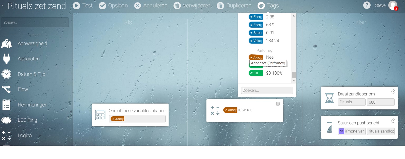

How do I set the Variable? I can create one in settings but there is no way to change this value.
The tag changes when I enable the Rituals device. So Homey knows when it on or off.
How can I link the tag to my self created variable?
I`m not able to put the Rituals device in the if colum so that I can set my self created variable via the then colum.
Can someone please help me?

That’s the moment to set a Better Logic variable.
After that use that specific variable in the IF colom.
The tag ur using in the IF colom at the moment is not a Better Logic variable, u have to create that urself.
I’m not able to use the rituals device in the if colum.
If was able to do that then I could set a value for the better logic variable.
So, how u activate the rituals then?
I am able to activate rituals via the then colum in flows. (So here I am able to set the better logic variable)
But if I manually enable rituals (via devices) I am not able to set the variable. Same thing when I enable rituals via their own rituals app.

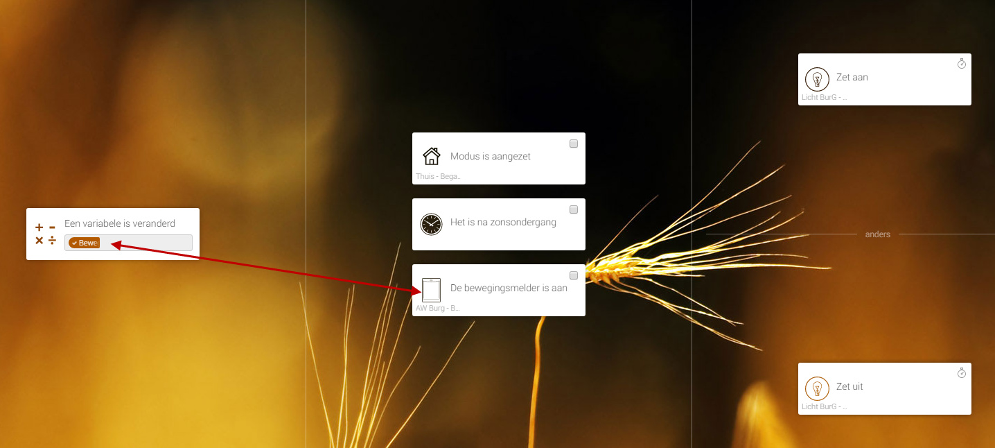

Same here, I want to use a tag as a trigger as well.
If this would be possible, a presense detector (aqara body sensor) could be used to switch lights on AND off using only one single flow (below).
Is this possible?
Homey knows the state even when I don’t use homey to put te rituals on.
So Homey has the information but I am not able to use that.
And also yes, when I start the device via Homey, I can see it as on in the original rituals app
So u want a tag as a trigger and
Then u should make a request for a “a tag has changed” card in the IF colom.
