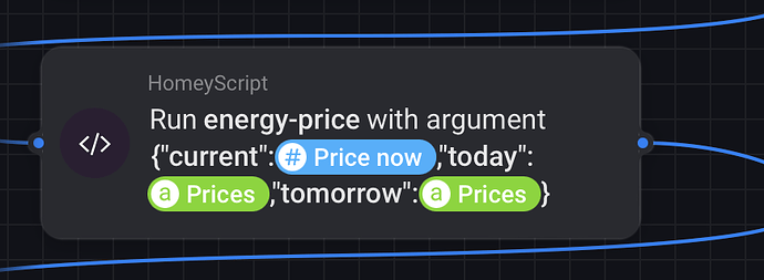

You can only really have one args as far as I’m aware, so what I do is I usually construct some json, and then call JSON.parse(args[0]) to get the values.

No, they made a Homeyscript (using the button I showed a few posts ago) called enery-price.js, and the card calls that script.
No, it’s one argument that consists of a JSON string.
Could you share that post Robert. I have looked under your activity and done a search but I can’t find it.
Just scroll up:
