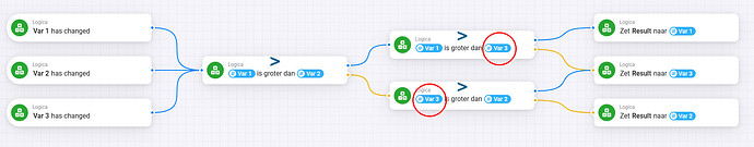

Because I know now that you use advanced flow I found it a nice test for myself.
Var 1 - Var 3 are your wind guts values.
Variable Result get the highest of those 3.
Look to the place of Var 3 in the tests .
This way you have only 3 end carts needed.
