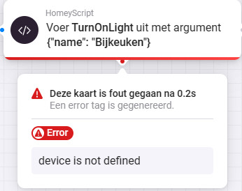

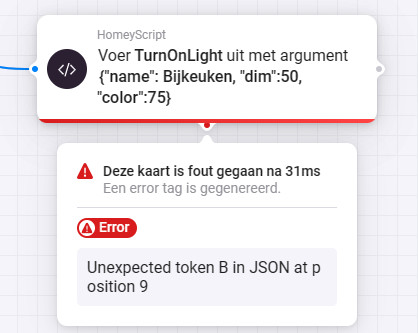

Trying to make a script to switch on a light directly with arguments dim and color, now in the advanced flows this costs me 2 ‘then’ cards, I was hoping to do this with 1 script call like underneath but sofar no luck getting anything to work (I am a machine programmer so these functions are really easy on a PLC, but for some reason it must be complicated in java :-))
Result:
Any idea how to solve this much appreciated
String-type values need to be quoted:
{"name":"Bijkeuken","dim":50,"color":75}

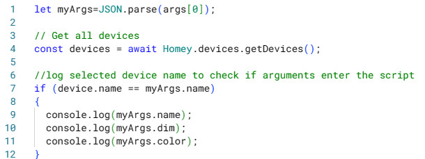

I actually already tried that, but then I get this error:
(simplified to only use 1 arg for test)
EDIT: script itself was incorrect, had to separate device from the list of devices, think it will work now, thanks
