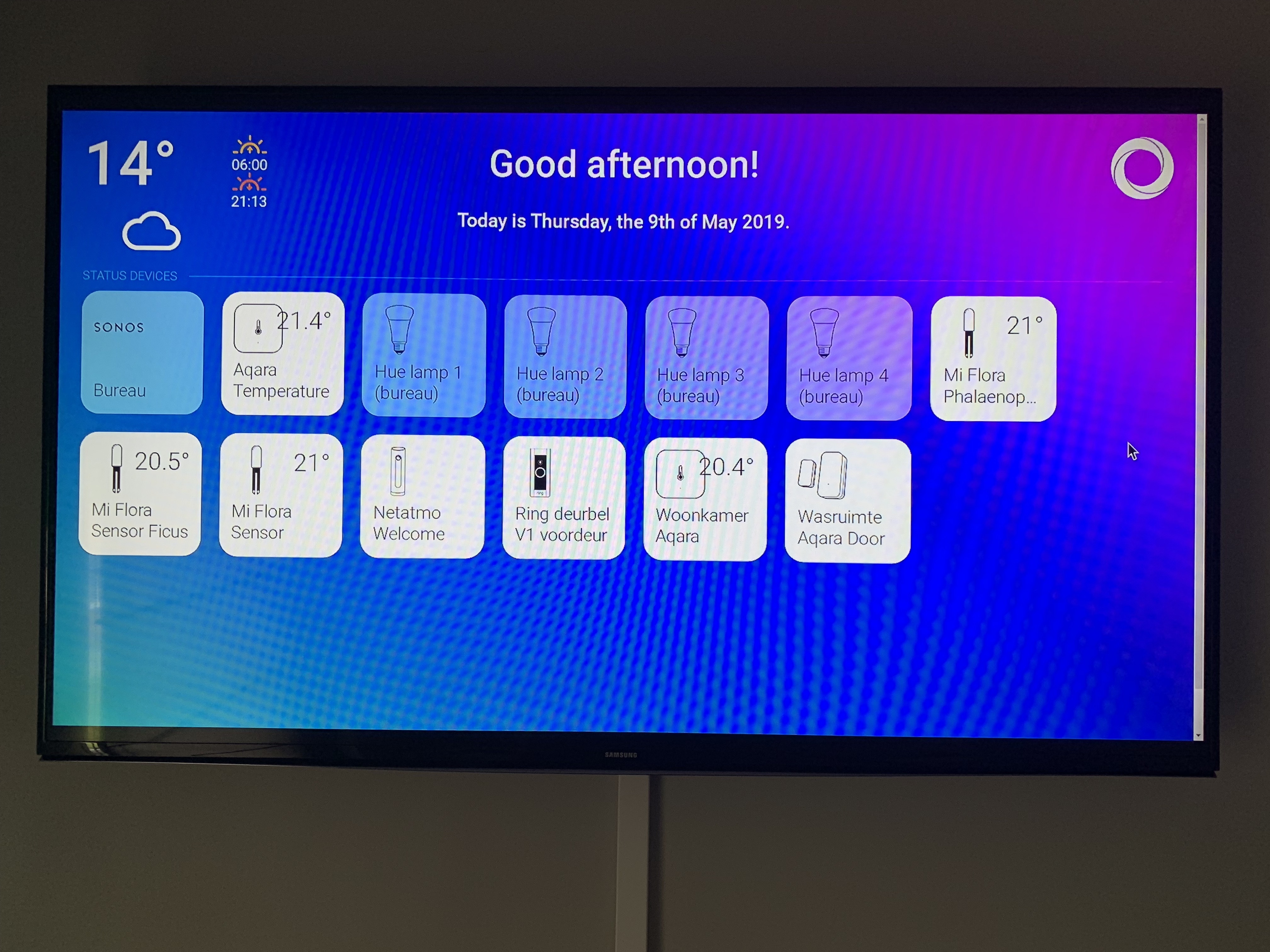

I’m running the version of @DaneedeKruyff on a Raspberry-Pi and works great, I now even have 3 different versions running also this is not a problem, I use different links for my different floors and working now on a status board in my desk that is shown on a wall-mounted TV, also this works great but I’m missing status info here on the icons.
1. For instance I’m using for all my doors and Windows Aqara door/window sensors, in the homey app I can see when a door/window is open/closed but in the dashboard I don’t see this orange indicator, is there a way, app to do this? (Fixed!)
2. Second problem is the temperature on the device buttons is too big now, can we change this? (Fixed)
3. Because I have no green fingers :wink: i’m using Mi Flora sensors, now I see the temp on the button but I would like to see if the plants need water, is it possible to change this? (Fixed)
4. I also find the buttons quite big can we change the size of these? and even better use or own icons based on the status of a sensor for instance, open door when sensor active, and closed door when sensor not active, that would be off course even better!
