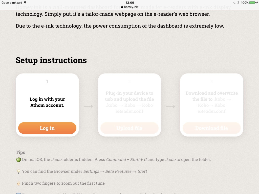

Homey.ink on a tablet/desktop
Weejewel said he casted a screen to the hub

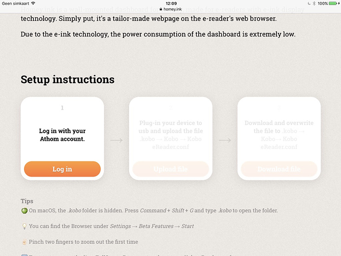

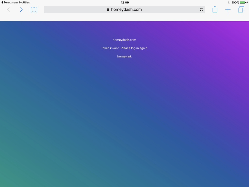

Hi @DaneedeKruyff, and other devs here, for me the online homeydash version does not work on my old iOS 9.x iPads, I get this error
When I click on the link to log-in again then I’m not able to click on the login button, its just not clickable anymore? looks more like an image than a button now, I already did a complete reset from the iPad but also this does not seem to work. What I understand its not a problem from Homeydash itself but on the side from Athom, maybe anyone an idea whats going on here and more importend how to fix this.
I’m using this link and token with no issue add all on all my other devices, iPad, iPhone, Macbook, Raspberry pi so I’m sure the link is not the issue here?

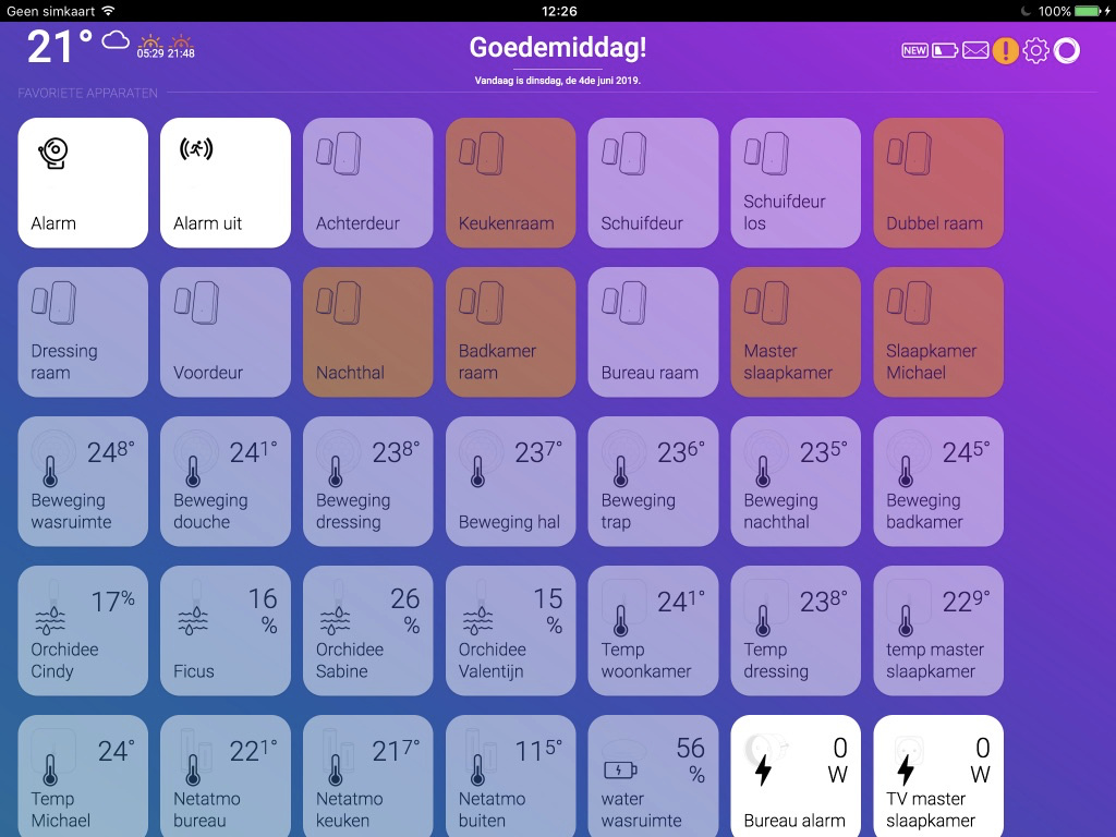

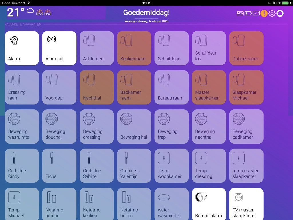

this is how it looks on my dash

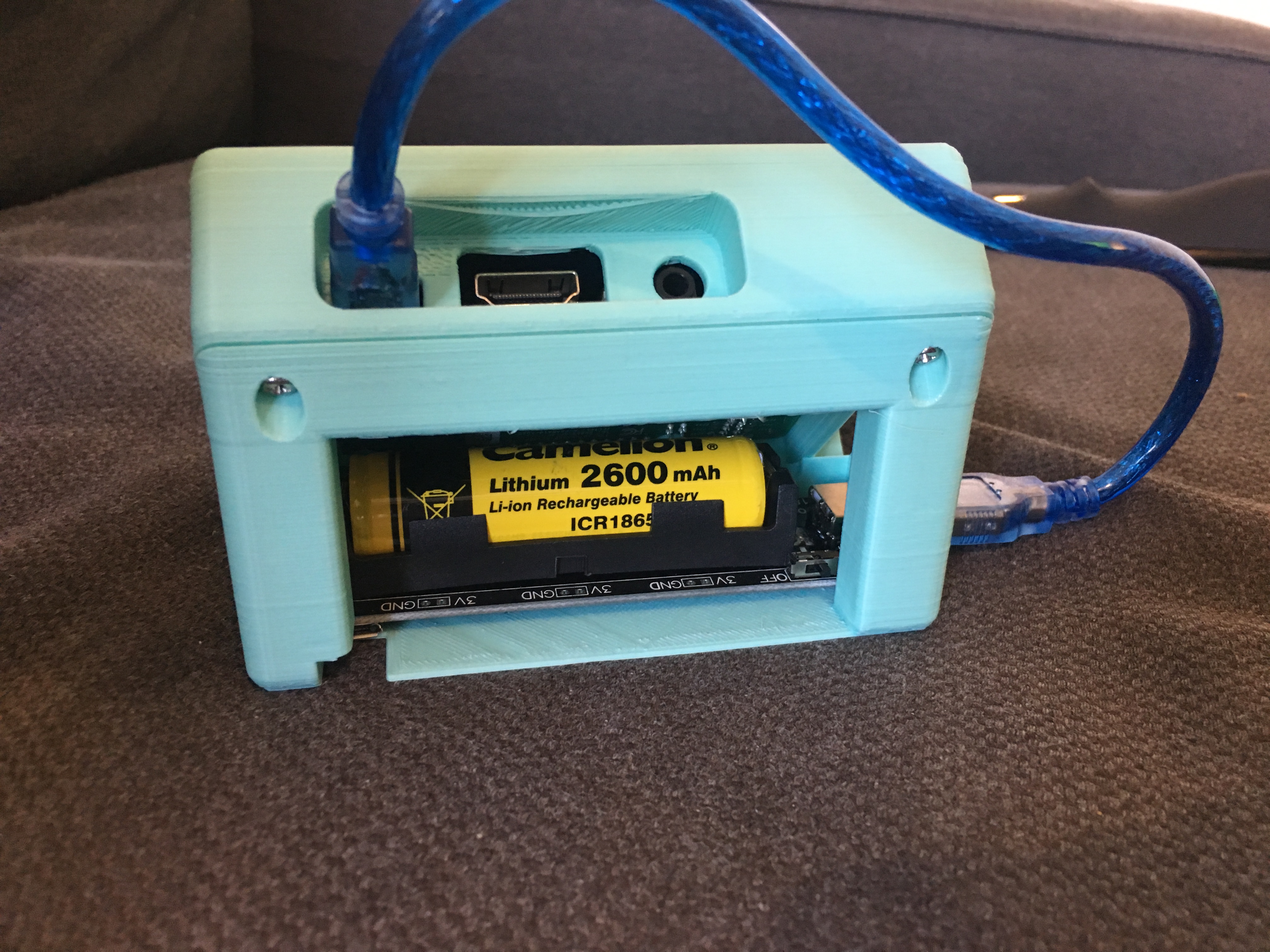

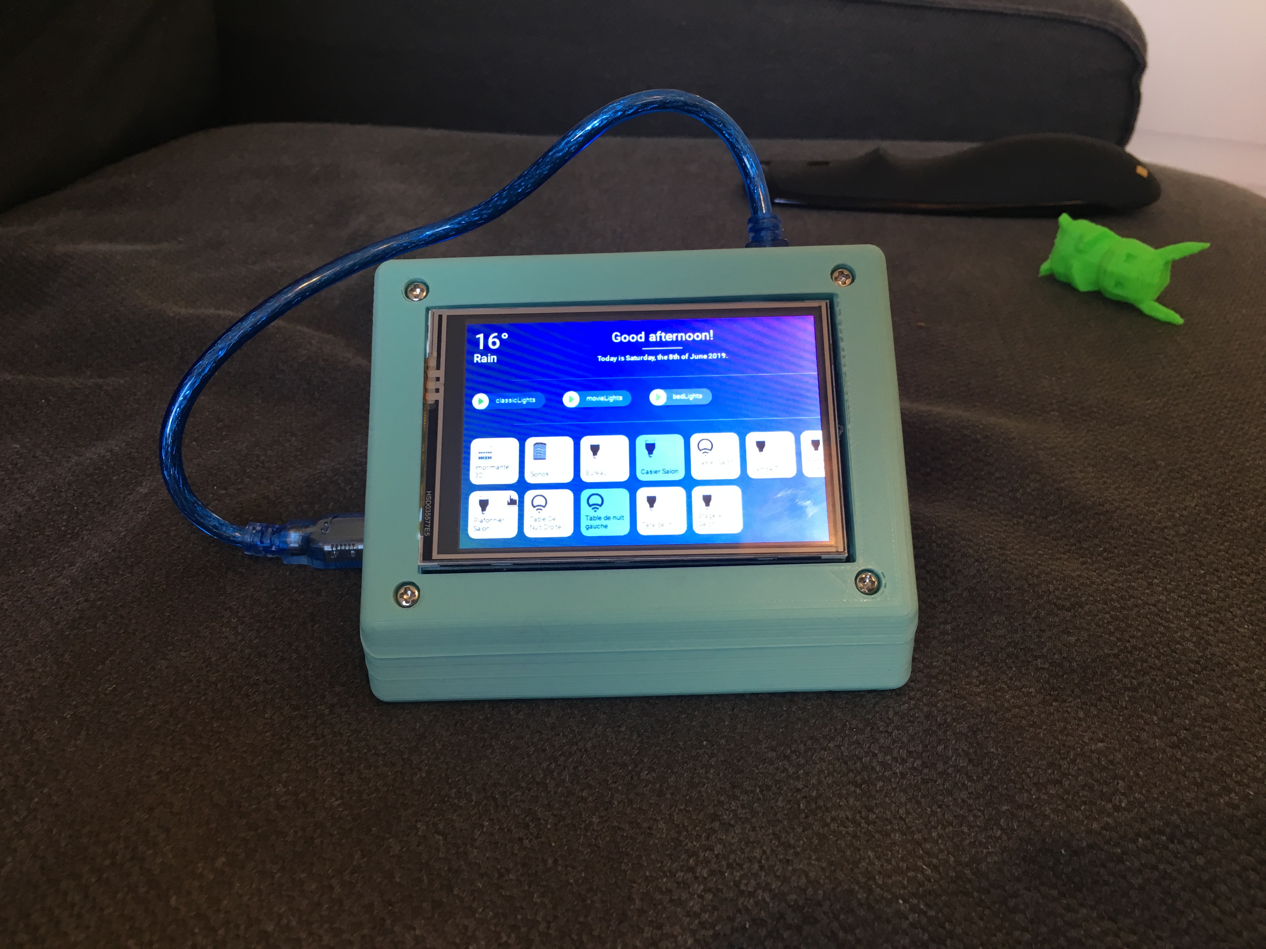

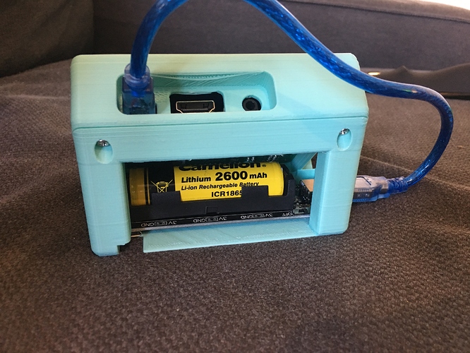

Look at this little monster (next step make some welds to delete this cable :slight_smile: )
I would be nice if the temperature shown up in the left should get value from a sensor already in Homey.
Right now the temperature is very off, often by 2-3degrees
