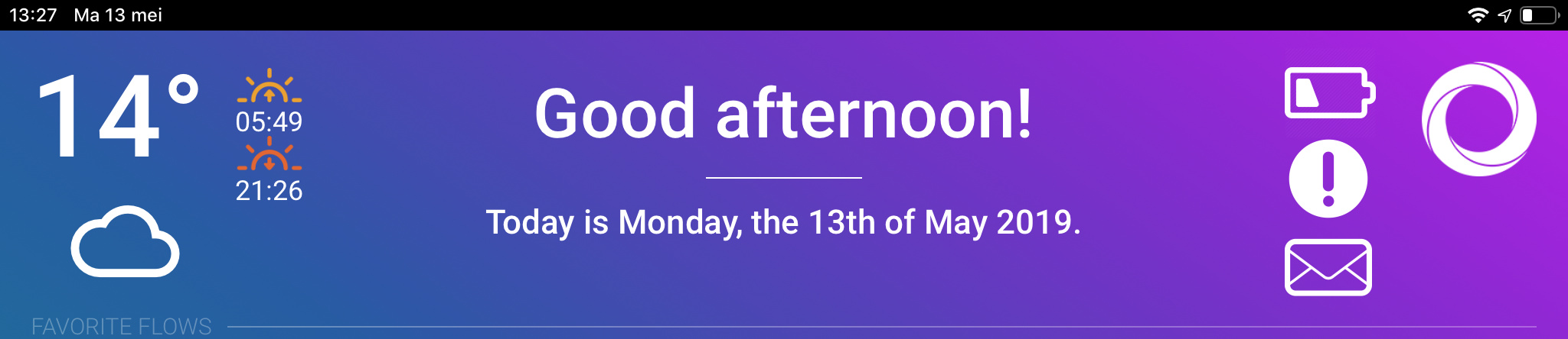

Ok everything was working fine, but now nothing wants to load anymore?
Using latest version from @DaneedeKruyff did not changed one character of code, but to be 100% sure even downloaded the latest version again from Github but same issue
Also installing the new update on my local machine is not working anymore, same issue as on the PI, , any idea?
This is what I get
