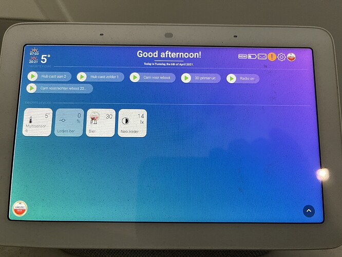

It can show all values a tile holds, not as a graph though.
The actual values can be shown, like battery % and such. It is updated realtime, no page refresh needed
Example
This is a local served dash though.
With the online dashboards, longpressing a tile shows the values it holds, in a cycle (next longpress shows next value). But, while casting it to Google nest hub, this isn’t possible, I heard/read, but I don’t own one. Then maybe a local served dash is an option.

Well, the information is not correct. It is indeed possible with a Nest Hub.
Check!
And is it correct the hub starts a screensaver every 10 mins, and a new cast command has to be sent from Homey?
Do the tiles still show the longpress value then?
T.i.a. Roco
This is correct.
Nope.
But i wonder if “ur” version does?
I never said it is “my” version, I wrote:
But “my” flavour should, it should, Glenn D. is playing with it b/c he has a hub and I don’t.
The longpress function is not needed, I just un-hid the tile values so they’re always visible.
But it only lasts for 9 mins. Very useful.
