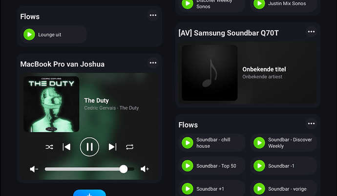

Current state
On the left (Macbook) is my current Spotify Connect speaker widget compared to right (Samsung Soundbar) which comes with the official app. Oh, and on the plus side: volume control isn’t tripping like the Sonos widget does :clap:

All capabilities work in the player! See screenshot below.
