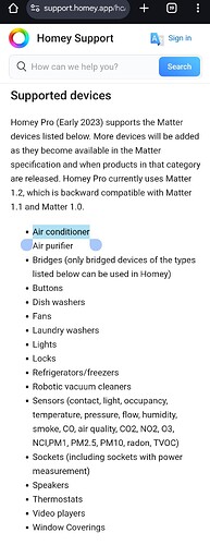

You got lucky, but only a little lucky :grimacing:
Unfortunately Matter is not Magic yet;
According to Matter 1.2, it should support temperature and fan mode control,
but only IF
  • HiSense implemented standard Matter functionality and not custom ones
  • Athom has implemented temperature and fan mode support (they don’t specify)
I think not. You, or a nice developer, should create an app, to add custom Matter clusters.
But I’m no expert at all in this, errr, matter
