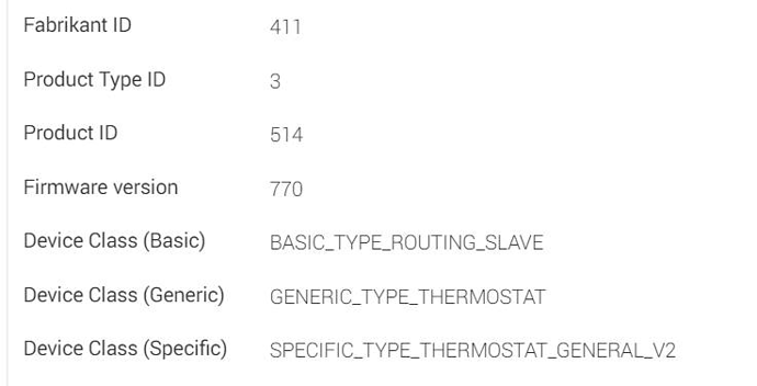

Hi Ramon,
Just to check because I can’t find a formal reference to TF033; what is the commercial name of this thermostat? Is it the Z-TRM2 or the Z-wave thermostat with FW 1.92?
Can you share some more details?
Can you also share a screenshot of the productID and productTypeID of this thermostat (when added as a basic Z-wave device)?
Hi Ted,
This is my screenshot, i’m using the Z-Therm2 ( Z-TRM2 )
Ah, that’s the Z-TRM2…
