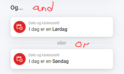

Will this situation be the same?
I am converting my normal flows to advanced flows.

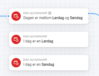

Here I want my heating pump to adjust to a certain temperature if the day is either saturday or sunday.
Will this be the same as setting up the card with: The day is between saturday and sunday like I have done here?
December 2025. I see there is an if - then - else now (maybe for some time already).
The blue line on top is the then, the gray line on the bottom is the else
This has always been available in Advanced Flow.
  • If the test in the flowcard results in ‘true’, then it executes the righthand upper / blue line;
  • If the test in the flowcard results in ‘false’, then it executes the righthand lower / yellow line;
  • If the test in the flowcard results in an error, then it executes the bottom / red line (if available).
When simulating flows Homey shows the unfollowed paths in grey.
